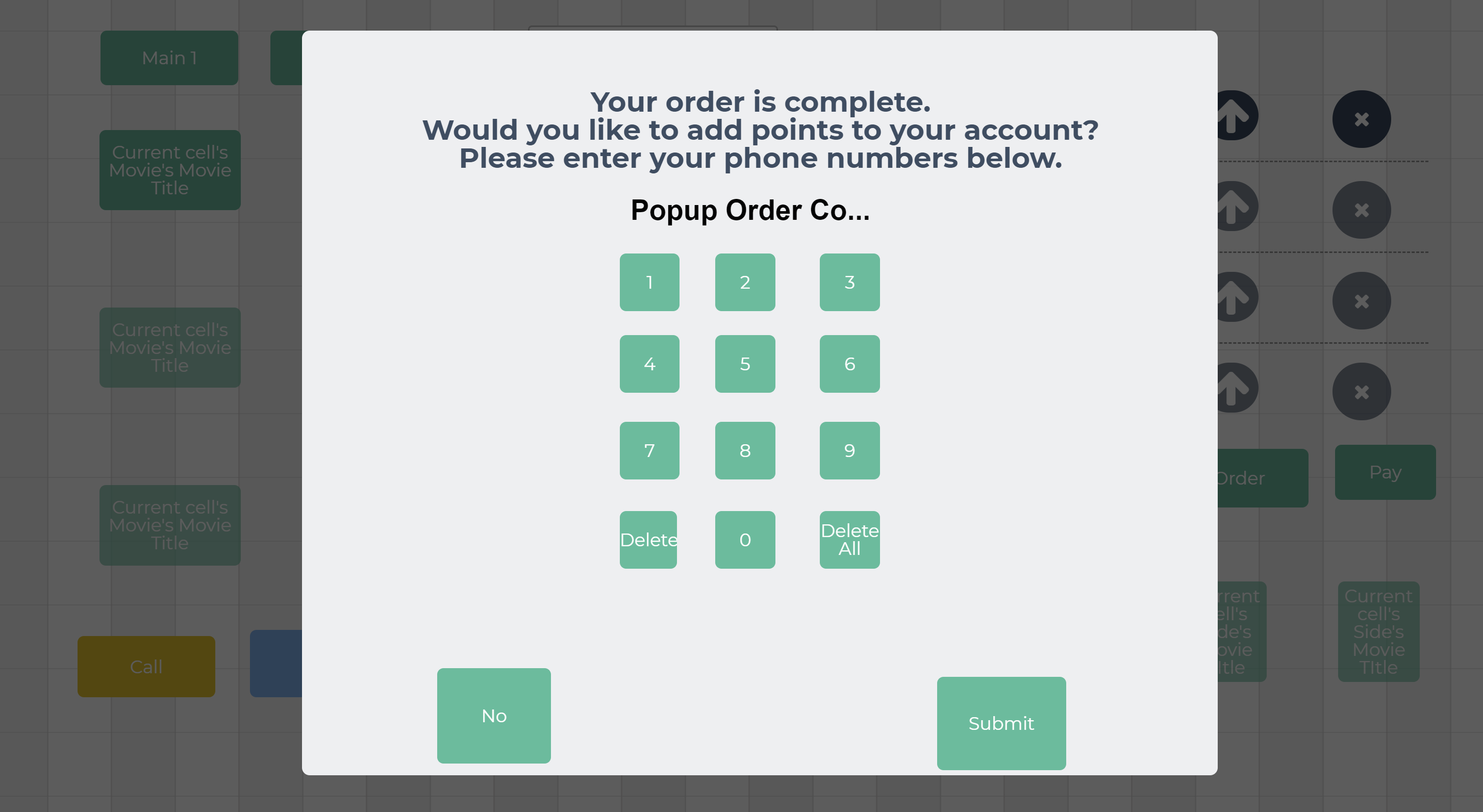

Hi, Bubblers!
I kinda followed an existing instruction to appear an alert message.
I think I set workflows well.
But It doesn’t pop up.
What should I do to solve it?
Screenshots are below.
When the submit button is clicked, I wanted the alert message to appear.
But in preview mode. The alert message doesn’t pop up!
What should I do?
Thank you for reading…

I found why I couldn’t see the Alert.
The reason was this.
The alert message appears in the dark area behind the pop-up like below.
(I couldn’t screenshot the moment when it appears. But I just inserted the image for a better communication. :sob:)
When I checkboxed ‘Set it to top’ on the Alert setting.
Then It appears above the pop-up. But it sticks to the top like header. I cannot move the location of the alert message.
Does anyone know how it appears above on the pop-up?
