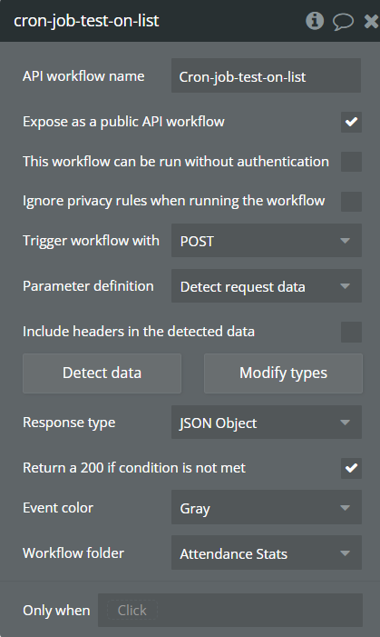

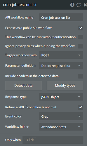

I created one API workflow on backend with these settings…

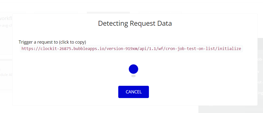

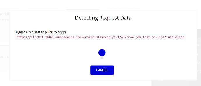

It triggers completely fine when i do “Test Run” on cron-job while the bubble’s “Detect Data” is active,
Detect Data is active means this:

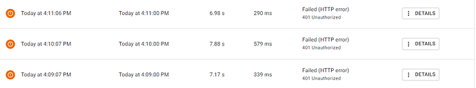

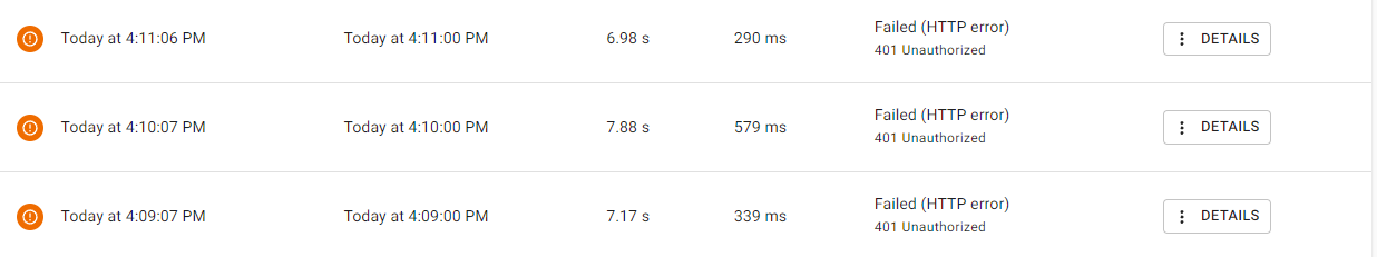

But after the Test Run is successful and i close the Detect Data tab on bubble, it stops detecting data hence the workflow is nor triggered. The cron-job execution history returns this error ‘Cronjob execution: Failed (HTTP error) (401 Unauthorized)’
What i need is, it should continue working even if i close the bubble tab, that’s what it was supposed to happen. Am i missing something?
You could try mark the “This wf can be run without authentication” property
It did not work. Getting 404 Not found error now
Ok i found the issue,
I was supposed to remove the /initialize from the URL that i copied from bubble while making the cronJob
Bubble gave me this:
https://clockit-26875.bubbleapps.io/version-919xm/api/1.1/wf/cron-job-test-on-list/initialize
Cron-job needed this:
I did’t knew that😅
Initialize is only to detect request data. Once it’s done, you need to remove it. Also, @Efe was right to ask you to uncheck authentication.
