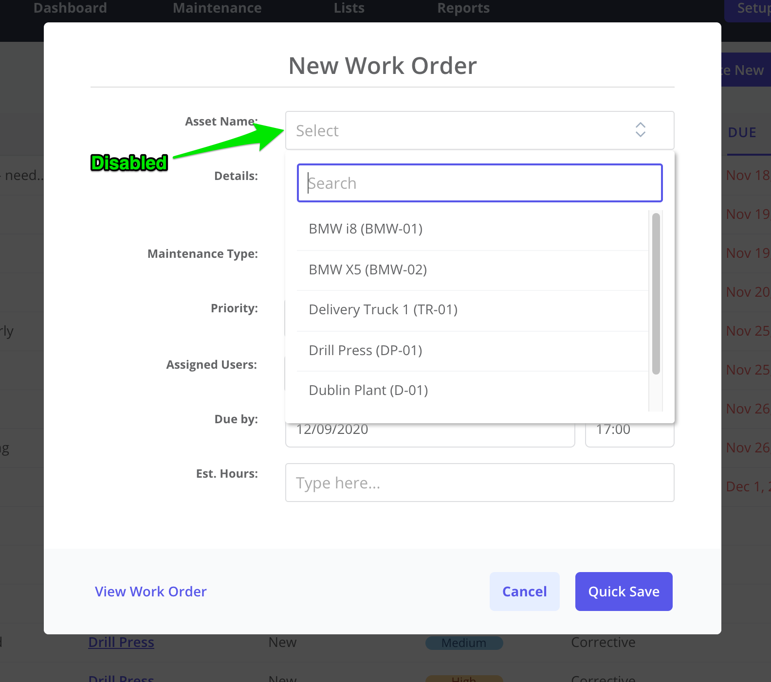

I got a solution to this.
Previously, I could type text into the input field and it would narrow down the list in my repeating group, or I could click an item on the repeating group and it would be supplanted into the input field.
This simple fix was suggested to me by Steve S. He recommended I disable the input field. That way the user cannot write into it and Google will not try AutoFill it:
I also add a second search field so the user can type in some characters to narrow down the list. They then click the item in the repeating group to populate the input field.
