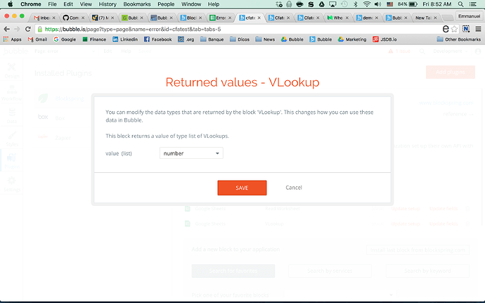

Also, when you click on ‘Update fields’ in the blockspring settings for Vlookup, it says ‘(list)’, that’s a hint that the data isn’t just a number with commas (we do display it that way if you don’t set it differently, but you can).

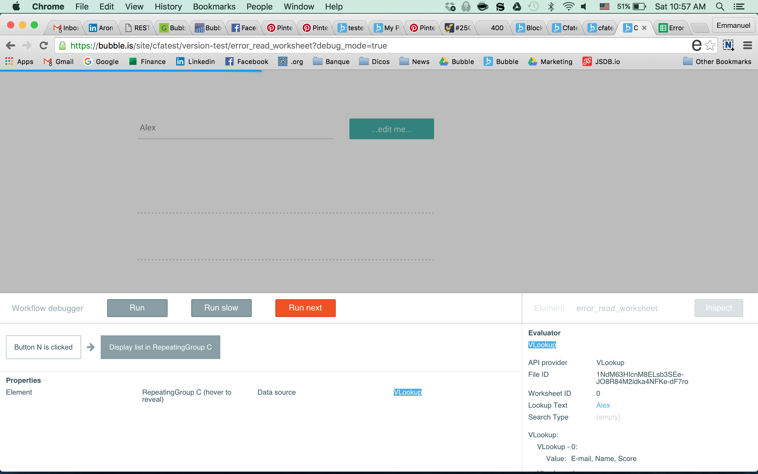

Check what I did here. That won’t work because the Google Block isn’t authenticated on this account, so replicate this in your account, but you’ll see the logic.

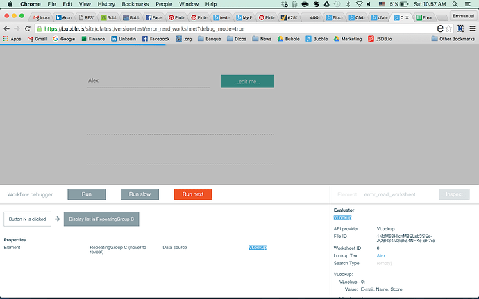

Well let me know. I didn’t do anything for the rating, just wanted to show you the logic for the Sheet block. I did make a few change to cfatest so that you can see how that works. One thing to keep in mind is the debugger. In this case (see attached), you can run the workflows step by step and see what is the evaluation of the block.
