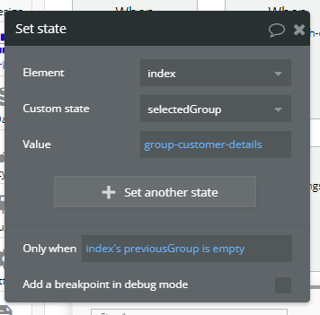

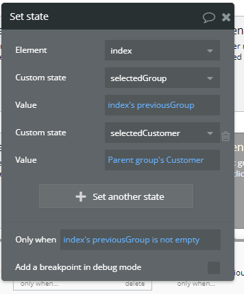

Thank you Ed for fixing this issue. For the benefit of others, I will explain the solution. Reminder: I needed to go from “my-customers” page back to different groups based on where the user just came from. A group is like a page in my single page app.
The index page has two custom states added previousGroup and selectedCustomer.
If I go from the group “create-invoice” to “my-customers”, we add the from information to the previousGroup custom state so it knows where to send Data back to.
step2
That get’s us back to the page we came from. Now, on the main “my-customers” group we add the following;
aaa
Notice that we are now sending the Data as selectedCustomer (Parent group’s Customer). That gets the correct customer back to the previousGroup.
Because the customer’s name goes to ‘customer-details’, Ed added another (default) state which directs the user to “group-customer-details” Only when index's previousGroup is empty
ccc
