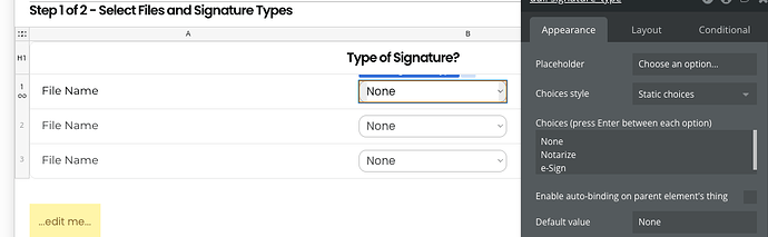

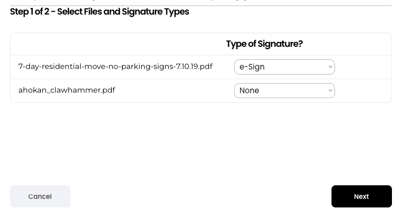

I have built a table and for each row in the table, I have a dropdown list, with static options, in one of the columns.
Oddly, I’m having a challenge restoring the ‘default’ value of the dropdown list when the user cancel’s their ‘transaction.’ For example, if the user were to cancel out of the scenario below (captured first screenshot) and returned to the screen, the first row in the table would be set to ‘e-Sign,’ rather than the default value of ‘None.’ Even worse, if the user were to open the popup from a record with different documents in the table, the first dropdown list would still be selected as ‘e-Sign’
I’ve attempted 'reset relevant inputs’ and ‘reset group/popup’ combinations in a workflow that fires through the “when popup closes’ event; i’m not seeing any changes with the attempts.
How do I ensure that all of these drop downs are reset to their default value, each time this popup window renders?
Here is how the table and dropdown list are implemented…

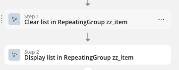

The only native way I found to do this in Bubble, based on what you described, was by clearing the repeating group and then displaying it again.
This way, you bring back the repeating group’s data and clear the dropdown.
Would this work for you? If not, we can think of another approach.
@carlovsk.edits , thank you! I really like the idea.
So, I gave it a shot (workflow below) but I still got the same results. I even tried tossing in some ‘reset relevant inputs’ into the mix.

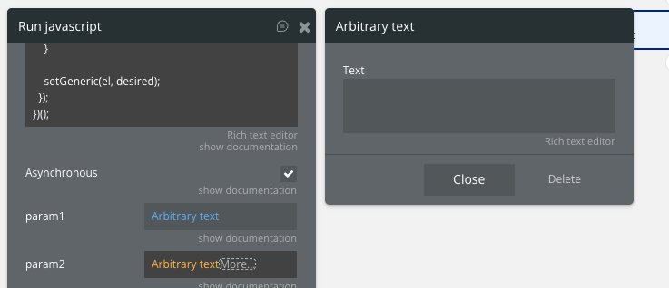

Here’s the JavaScript code I made for the Run JavaScript action (Toolbox plugin). It should help you:

In param1, you set the dropdown IDs:
You can also use just one ID if needed.
And for the param2 value (the value you want in those dropdowns), you can set something like None, and all dropdowns with the provided IDs will take that value.
If you leave the value empty (as shown in the image below), all those dropdowns will be cleared:
