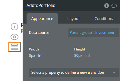

I have a RG with thing type investments that shows a result of a search. I then have a reusable element that is another RG showing showing a list of current user portfolios.
The RE group is set to Investment, but the RE is set to Portfolio
When I try to create the workflow I cannot seem to relate back to the selected Investment in the original RG.
Please could I get some advice on how to structure this functionality, ie A user selects the portfolio icon for a particular investment and then assign it to a portfolio.
Hey,
According to the last image, you have to set RE data type to investment and add RE’s investment for that workflow, and In Primary Investment RG, when the user clicks on an investment, send the current cell investment to RE.
