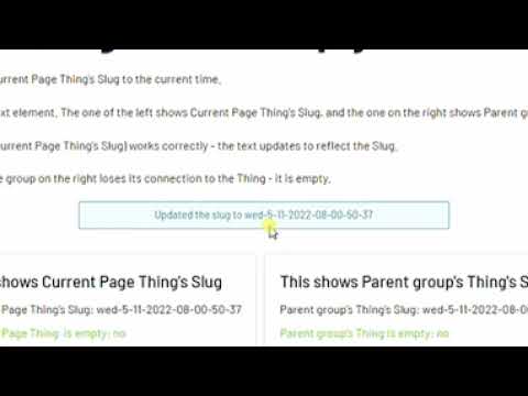

An update on this. I was in touch with support and they tried it on the demo page I created - and it works fine for them. I went back and found it now worked fine for me… for about 5 or so changes, and then breaks. The app where I first observed the problem is also showing the same behaviour - i.e. it now works the first few times. Am investigating further.
I’ve made a new demo which updates the slug repeatedly until it breaks, no user intervention required:
I would be grateful if people can test this and report back how many slug changes it takes until the box on the right shows some red text.
Sheesh, it takes anywhere from 5 to 56 changes for me - but eventually it does break!
Demo of the problem with full explanation. This demo takes an unusually long time to surface the bug - over 60 slug changes. Usually it’s been a lot less than that.
