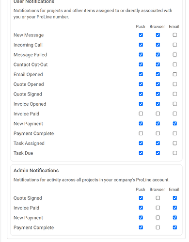

I have this UI for toggling notifications, and I’m using auto-binding for each option on the user (yes/no) field.
When you click to toggle a checkbox, it can take up to 3 seconds to actually react and select/deselect it. Basically, it freezes up the browser for a second.
Any ideas on how I can avoid this on my end? Or is this a bug?
I’m wondering if maybe Bubble is doing the auto-bind operation before it is changing the input to reflect the selected/deselected status, when it should be the other way around to ensure expected behavior visually.

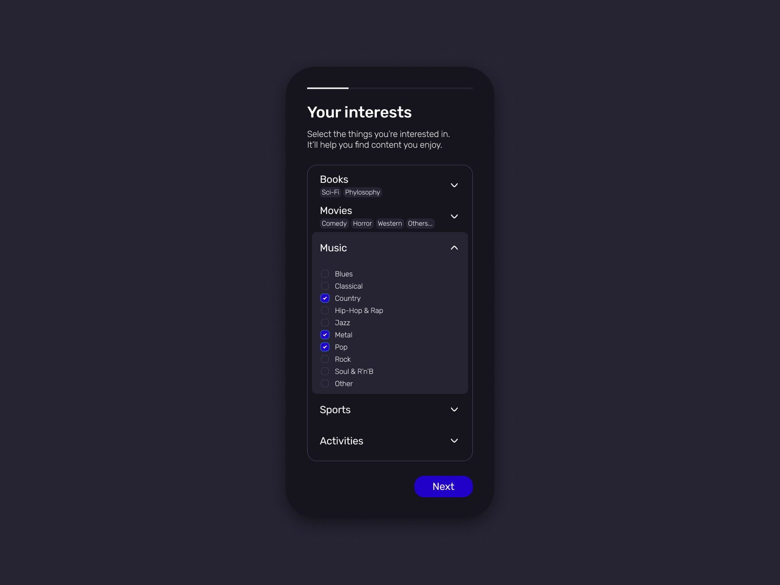

I have a hunch it’s due to the fact you’re showing so many fields on the page at one time. I believe you will increase the performance (and also much improve the UI) if you implement an accordion like this:
Where you use a state (call it tab…) where each section is only visible if the tab state is equal to a specific value. This way, you’ll eliminate the possibility of the sheer number of fields being a performance hindrance and your app will appear to be more polished.
