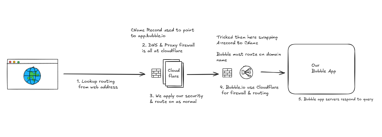

Apologies for pulling this one from the depths! But I’m doing a PoC on this and wanted to confirm everything still works as intended for those who made the switch.
Our app is behind a subdomain which makes this easier. My steps were:
  • Put full sub + domain name in the bubble.io dashboard for domain verification
  • Add the provided A records to the DNS settings in Cloudflare but ensure I turn off Cloudflare proxy (orange cloud disabled)
  • Check connection on Bubble to get verified domain status
  • Delete A records from cloudflare and provide a single CNAME record with our subdomain as the name and pointing to app.bubble.io
  • Turn on Proxy for the CNAME and everything works fine
  • Turned on IPV6 transforms to IPV4 in cloudflare settings
I then went and added our own security rules around headers and stripping out x-powered-by etc and all looks good.
I can see that bubble domain settings are now complaining about the IPV6 routing and such but I think this can be ignored am I correct?
I’ve drawn up a rough diagram about how it used to look and how it does now. The big lie is the CNAME switch out from the A Records we had before. I assume they just grab the domain that got verified and match it to the internal bubble app id.
