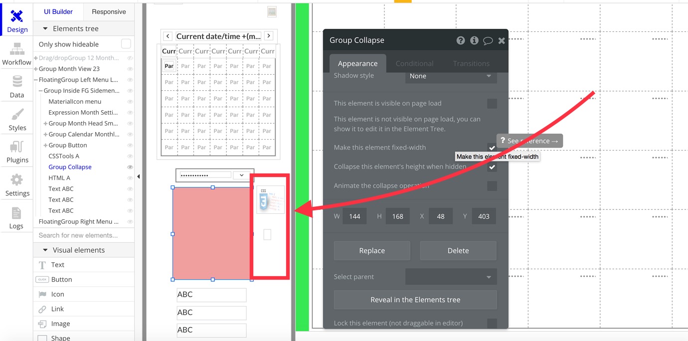

Now the real problem is that the group does not collapse when hidden the text below does not move up as it should
  1. Working app ( group is collapsed and text moves up )
  1. Not working App ( group is hidden but does not collapse as text below does not move up )
Any insight as to why something that is set up the same way ( basically just copied from other app ) would work in one app and not the other?

Did you try deleting the non-working one (the copy) and rebuilding it from scratch?
Copying in Bubble does not seem to be 100% reliable at the element level. Cloning an entire page or an entire app seems to work more reliably.
Hey there. I know sometimes these things are frustrating. Make sure there is nothing hidden around or behind the object you are trying to hide. Also make sure it’s not overlapping anything too. Check these objects. May need to move things around.
Thank you so much for taking the time to take a look at this and point out what my eyes couldn’t see.
This was the issue, and it is something I need to stay more aware of as I have had problems with the CSS element on the page causing issues with layout before.
Do you have any tips on where is the best place to put the CSS element on the page so that it is still functioning but doesn’t get in the way of any other elements? I’d like to have a “best practice” so that I could always place this element and others like it in a “safe” place.
My concern on this is really magnified when attempting responsive design for mobile and the page size doesn’t give much extra space to place the element.

I like to put everything in a pop up. I wonder if the css would work the same way if you put it in a pop up like I do with everything else. May be worth trying. Keeps everything clean.
Good catch! JS and CSS elements work in floating group set to float “beneath the page”, couldn’t get them to work in hidden popup.
However, I don’t think you can move/cut/copy them from where they are into the floating group. Have to create new elements in floating group and fix all your references to the new elements.
Maybe try moving it into a regular group and then change that group into a floating group. That might work.
