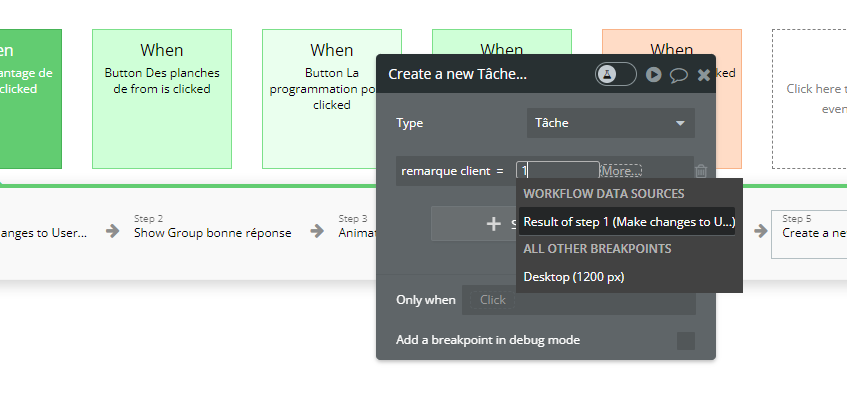

Regarding this option, @Rpetrubu, I’ve tried, but I must be formulating the workflow incorrectly!
I also tried the second solution @georgecollier but I didn’t found the thing’s remark = current cell’s button’s
Why this is not working?
Press ENTER ![]()
Can’t you write “1” in this field?
