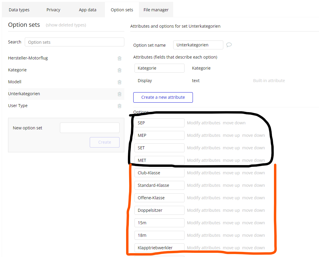

You need to establish a relationship in the database. For example:
Manufacturer
  • name (text)
  • logo (image)
Model
  • name (text)
  • logo (image)
  • Manufacturer (Manufacturer)
This means every model is associated with a manufacturer.
And we have 2 dropdowns on the page:
  1. Manufacturers
  2. Models
In the models dropdown, you need to set this query:
Do a search for Model -> Manufacturer = Dropdown Manufacturer's value
Whenever you change the selection in the manufacturers dropdown, it will update the query in the models dropdown.

  1. Do I need to set my database in the “Option” or the “Data Type” section?
    right now, I have set it into the option section
  2. When I do the “Search for…” function, I can’t select the Value in the first Dropdown Menu.
I have attached two screenshots. The first is my setup for the Page Itself. In this example, it is the relationship, between aircraft type (e.g. Engine Powered Plane and Glider) and availiable sub-categories. The sub-categories I have attached in the second picture. The upper half is the sub-categorie for engine powered aircraft and the lower half is for the glider. I have also set the attribute glider or engine powered aircraft to each sub-categorie.
