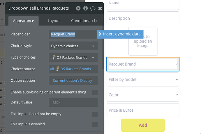

Here is dropdown 1

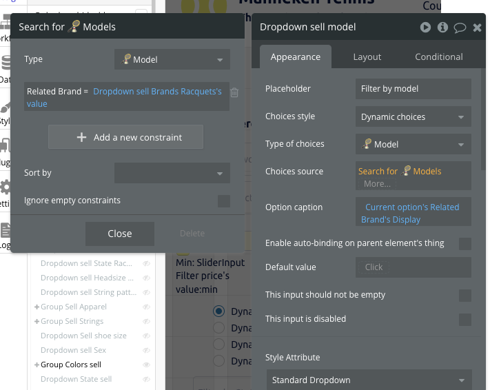

Here is dropdown 2
Here is the issue (dropdwon 2 doesn’t show anything)

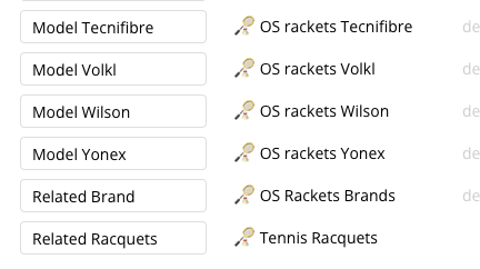

Here is my database structure:
This is Racquet DATATYPE
relationship
And Model DATATYPE
OS models

I get the idea of constraining, (which is something I have already done==> see screenshot) that was not my question, yesterday in another post I asked you how you would organize my DB and you didn’t answer, then in this next post I put every element I have and know, and I know there is a lot of information in the forum , if i post again it is because i’m struggling with that.
Your answer 5 minutes after my post indicates that you didn’t check my DB structure and screenshots and said “add a Brand field to your Model datatype” which is something I have already done.

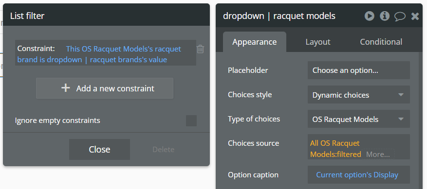

First, what George said.
Second, you are mixing option sets and data types in a way that doesn’t make sense.
Third, you really only need two options sets… one for brands and one for models.
Fourth, you can either add a racquet brand attribute to the OS Racquet Models option set or you can add a racquet models attribute (list) to the OS Racquet Brands option set. If you go with the former, associate an option from the brands option set with each option in the models option set. If you go with the latter, associate a list of models with each option in the brands option set.
Fifth, get rid of the Model data type.
Sixth, get rid of the Model field in the Racquet data type, and create a new Model field that links to the OS Racquet Models option set.
Seventh, leave your brands dropdown the way it is.
Eighth, in the models dropdown, get all of the options from the models option set, add the :filtered operator, and constrain the filter based on the value of the brands dropdown.
