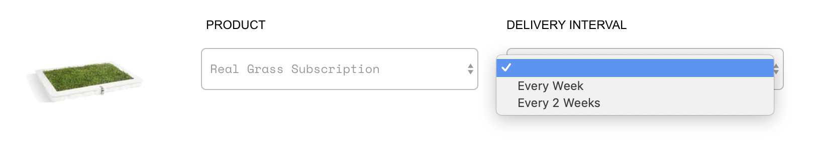

Hi, I’m new to bubble and I’m having some issues understanding the database.
I have 2 dropdowns that reference the same data group.
I have 2 dropdowns that successfully search the data group, here is the header and some sample data.
Product | Interval | Type
Grass | 1 week | subscription
Grass | 2 weeks | subscription
Starter Kit White | one-off | product
Starter Kit Black | one-off | product
If someone selects grass in the first dropdown, the second dropdown will show 1 week and 2 weeks in the dropdown (I’ve successfully done this)

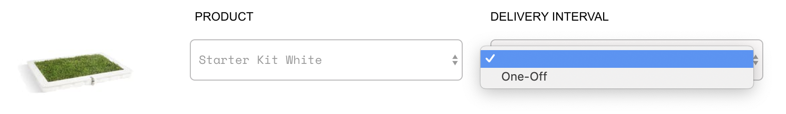

I want to be able to hide the second dropdown if the “Type” is not “subscription”
I haven’t been able to workout how I can determine the visibility of the second dropdown by relating back to the database based on a field related to the first choice dropdown without me having to tell the second dropdown to hide if the first dropdown contains “starter kit”. This works but I have a lot more data and want he visibility to be based on a related field in the same row of the data.

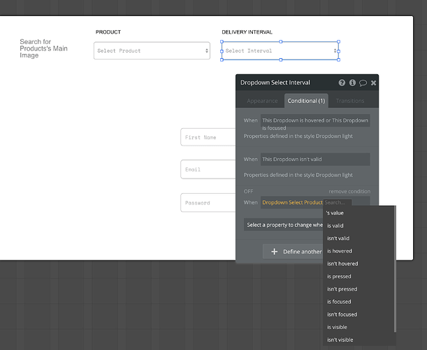

I totally understand what both of you are saying and I know that’s what I need to achieve but I just don’t see the option to say that the “type” = “product” or refer to another value in the dropdown 1.
Maybe I’m missing something…see attached
Morgan
The reason I didn’t want to use the yes/no and reference a field type is because I have more than 2 types but I only want to show when there is a subscription. But perhaps I need a yes/no field in the database to use type?
