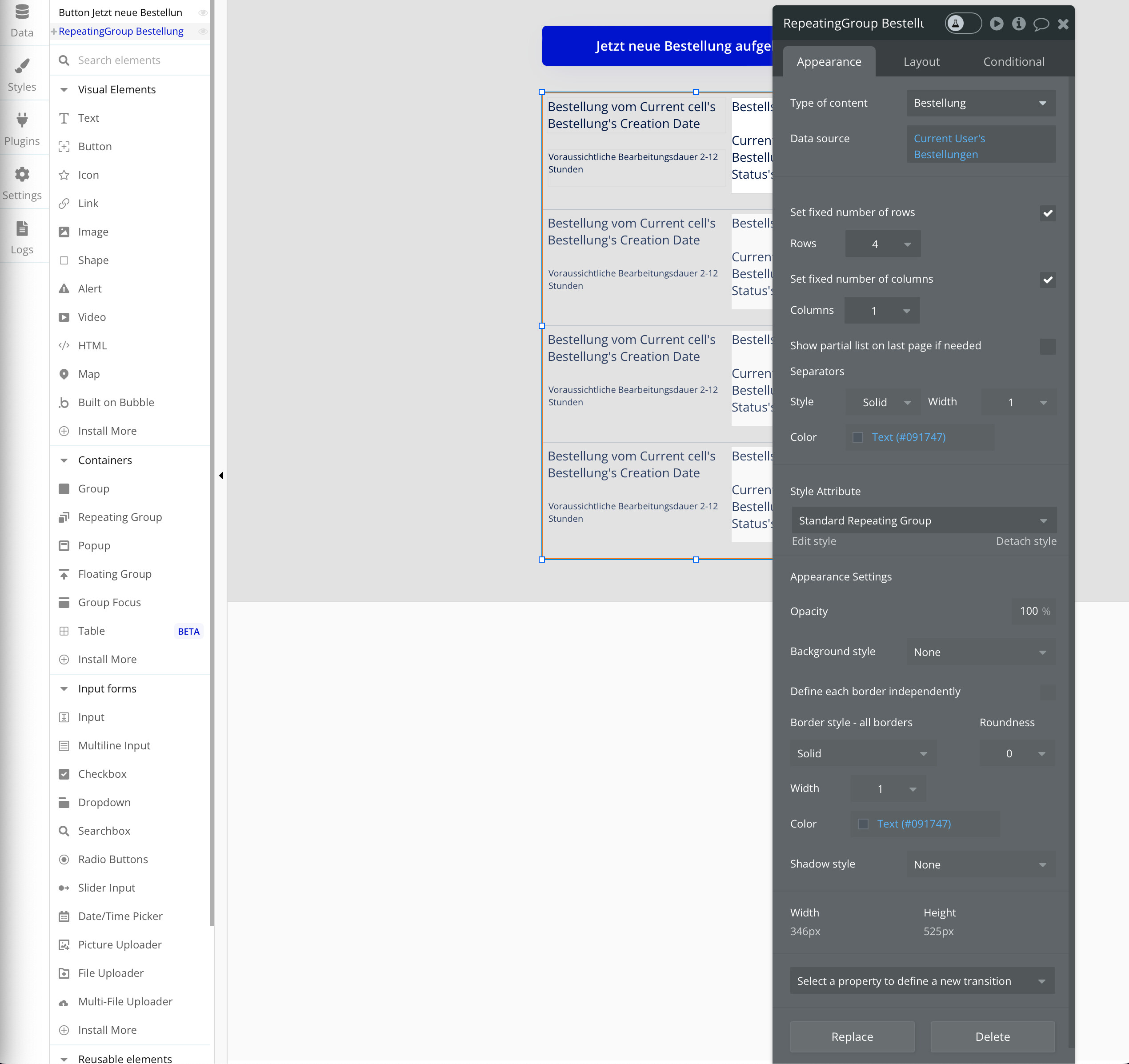

Hi and thank you for your reply, I have checked with the original RG where the problem first ocurred. Type of content and Data source were both selected:

If the repeating group has a data source and is showing data, then static content such as an icon would also show up in each cell. If you have a repeating group that isn’t showing data, it usually means it doesn’t have a data source, there is no data to show, or privacy rules could be getting in the way.
