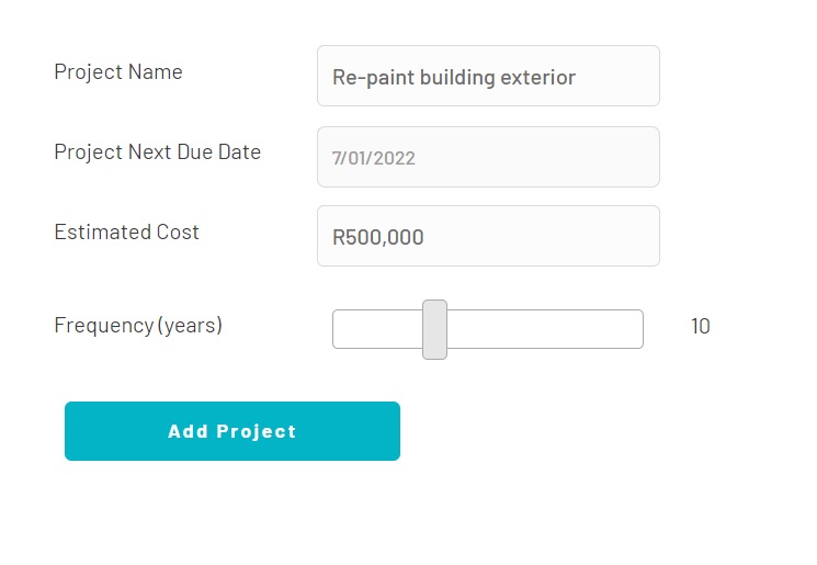

Hi @twilson9034 , the user will fill out a simple input form, as below. That then gets saved to a database of projects.
I am now trying to develop a page where I can show a list of upcoming projects. So if the user selects a date range, say 2020 to 2040, this project should come up twice, 2022 and 2032, as it is a 10 year frequency.

Project Input Form
