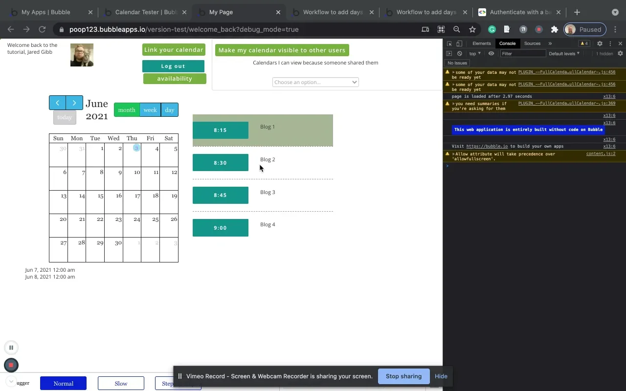

@jared.gibb this is great, it does almost exactly what I’m after :slight_smile:
The ideal next step would be to highlight every 4th (for example) date in the output table. The use case for me is sharing 10 case studies in a repeating pattern.
In the attached screenshot, I’ve Copied and pasted the output from your app into Excel, then put placeholders for each piece of content next to them and manually highlighted. Do you think it is possible to complete this operation in Bubble as well?
for sure. in a repeating group you could use a group as the holder for all cell elements
you can use a conditional to set the background color
Screen Shot 2021-06-03 at 12.09.32 PM
Background color = green
produces this
