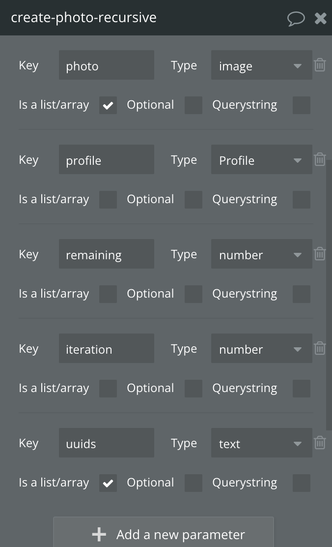

My API workflow has these parameters set:

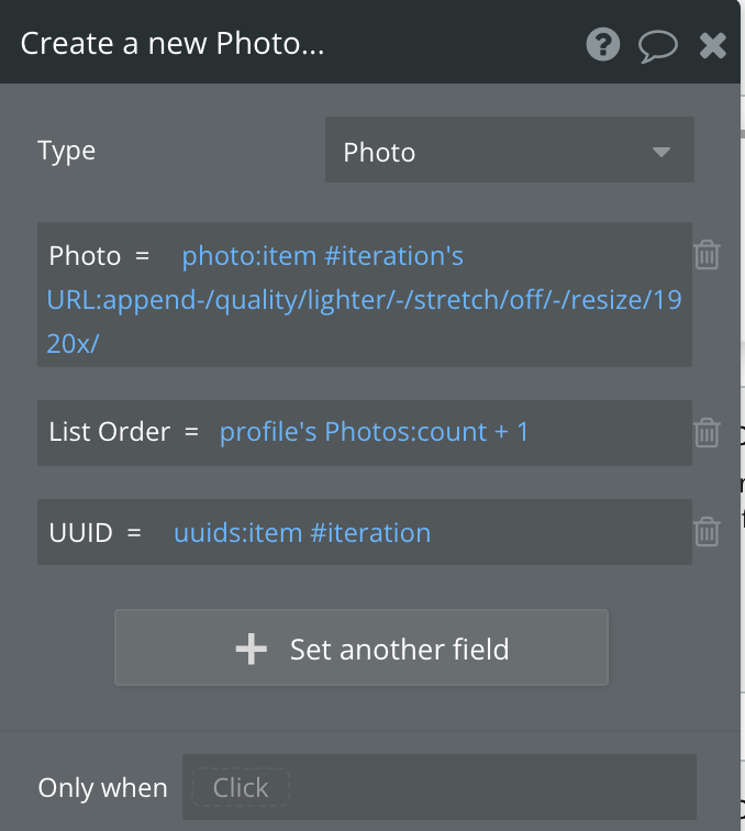

Then in the backend workflow, you create the photo:
Then you can add the photo to the current user or profile, and as the last step in the workflow, schedule an api workflow and select the same workflow you are currently using. You increase the iteration by 1 to move to the next item in the list.
I’m using a ‘remaining’ parameter so the workflow only runs again if there are more Photos to create - this stops you from creating an endless loop. Alternatively, you could say only run the workflow if the iteration # is less than the # of image items in the list.
