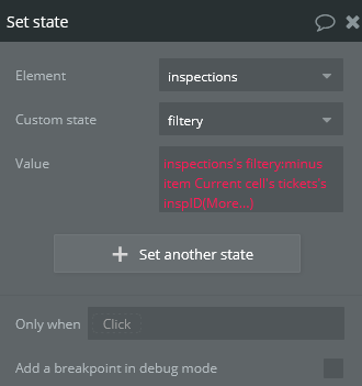

Thanks! it looks like this is what i need… but i’'m hitting an issue here with adding a list-item to my state in the workflow for either :plus, or :minus … it goes red when trying to input my number field [inspID] (see screenshot)
Annotation 2020-06-23 224757
(i have this issue elsewhere on bubble as well, i have to add ‘decimal’ formatting to the end of this string for bubble to let me save, but it still won’t enter into my app data for some reason)
What is the error that is displayed in the issue (issues listed in top right corner)
