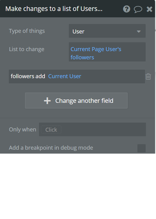

It says it adds the user to the list but when I check in the database it remains empty?
Did you make sure the list to change is grabbing the right item? (You can select that during debug mode to see which item it’s grabbing).
Yes, you can see it in the picture above.
