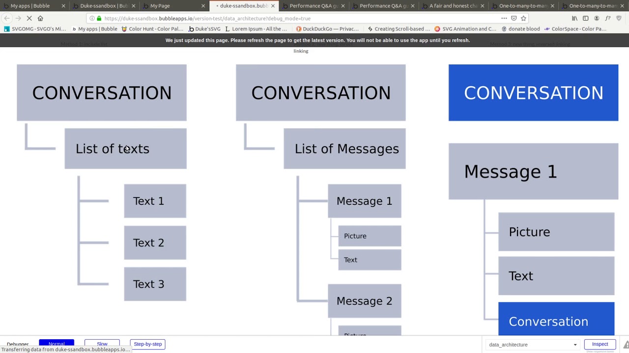

Just one quick question for now, if you don’t mind answering. I recall you saying that is it important to not store too much data on one data point, so does that mean creating more ‘things’ and then referencing them as opposed to trying to have lots of data within one ‘thing’ / data point. In the attached screenshot, if I understand correctly, in the forum post about performance @josh advised against having lots of referenced ‘things’. Apologies I may have got my terminology a bit muddled up.
Thanks in advance.
Nope you got it. The issue is not HAVING many things, it’s referencing a thing to a thing (to a thing ands so on) and trying to pull that data. The issue is that instead of directly pulling the thing directly, you technically are pulling two or three things to get the one you need, which is redundant. Instead, you can use a single field in thing(n) and say do a search for Thing who’s [text field] is [value that will reference the correct thing]. I talk about it in a little more depth here:
