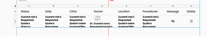

I’ve created a group table with a data type of requested quotes, each row containts data fields from requested quotes such as location, data etc.
I’ve got a row with an rubbish can icon to delete the requested quote. and have created a workflow as follows.
In preview mode, it removes the current row however, it is not removed from app data, so when the page refreshes it returns? any ideas?
is it a bug or am i just removing the information in that specific box in the table?

It’d be helpful to get a bit more info as your application and setup seem to be setup correctly. Are you doing anything with states on your page? What is your table’s data source? Any plugins involved?
The Table element is still in active public beta, so it’s always possible it’s a bug, but let’s try and narrow it down first-

No plugins involved but i do have custom states.
On my navigation bar/header, i have it so that when a user clicks on quotes, they get sent to another page along with a parameter to trigger a custom state which makes the table visible.
I’m assuming its only temporarily deleting the current row because its open as a custom state.
I don’t know how I’d go around that.

Same problem here : Deleting a thing using “current row’s” in a Table element is not deleting the Thing in the database.
Hope they ll fix it soon
Here is a workaround that is useful in several cases with new Table Element :
Instead of refering to “current row’s” thing, create a group inside your cell. This group has “current row’s” thing as a Data Source.
And then, inside this group, put your Text/icons/workflows, and they’ll refer to “Parent group’s” thing.
