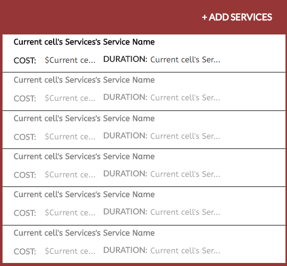

I have a list that users can provide the services they offer… See below:
What I would like to allow the users to do is once they have created the list. In instances they should be able to update any of their services and delete as needed.

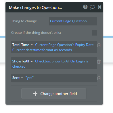

An example of the make change to a Single thing. I have one Question on my page, I want to change just that.

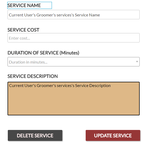

Thanks for the reply… I think I got it. See the screenshot below:
This is the actual page that I’m trying to allow my users to update or delete. When I built my app I didn’t take into account users being able to update and/or delete their offered services as needed. What I would like them to be able to do is click on the desired service in a repeating group (which is in my initial post). Then either use this page to either delete or update. Based on what you explained sounds like I should be using the “Make Changes to a Thing” functionality? Correct?
Yes, as you know exactly what the Service is “Current User’s Groomer’s Service” you can Delete or Update that. Don’t need the list version at all.
Thank you for your help and clarification on this. I think this is what you’re referring to:
What I have is “Services” is the name of the list then the fields within that list is:
  • Service Name
  • Service Duration
  • Service Cost
  • Service Description
Everything in those fields I would like to delete which would no longer show up in the repeating group list.
Yes, that what I was talking about. That removes the Service from THAT Groomer. But doesn’t delete the Service, it is still available for other Groomers.
Thanks Nigel, all set. Worked like a charm!
