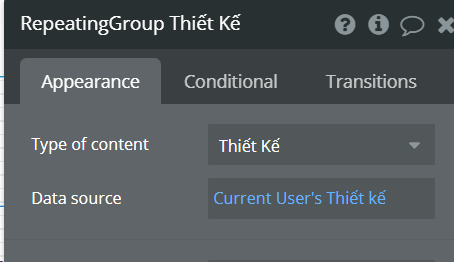

The repeating group:

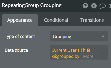

Bubble error states that list to delete should be list of orders, although it is impossible to change the repeating group from “Grouping” to “Orders” since I used the groupedby function
Is there any way around this? To delete a group of orders from a repeating group?
Many thanks
Edit:
Deleting a single grouping doesn’t work either as it states that it is not a savable item:

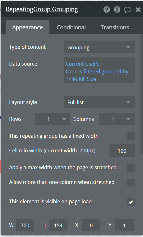

No worries and thanks for the suggestion! The ‘Grouping’ isn’t actually a data type I created but bubble’s automatic data type when the :grouped by function is used.
For example:
Best regards,
Phat
Sounds like it might not be a data type then? Is it a state?
Click the “i” icon in the top right of the inspector. See if it lists grouping as a state there. If not, then see if it’s an option, or another part of your data tab.
Type of content refers to a thing that you can access. You just need to figure out where that thing is, and then create a data field in your orders that allows you to access your orders when you’re calling the groupings.
