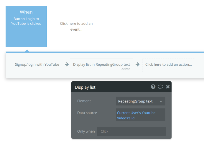

One way to do this is as follows (I’m sure there are other ways)
  1. Set your Repeating Group’s type of content to text
  2. Set the video element’s video id to current cell’s text
  3. In your workflow, on button click, after logging the user in with youtube, display data in your repeating group (Current User’s YouTube Videos)
Some screenshots that may help:
