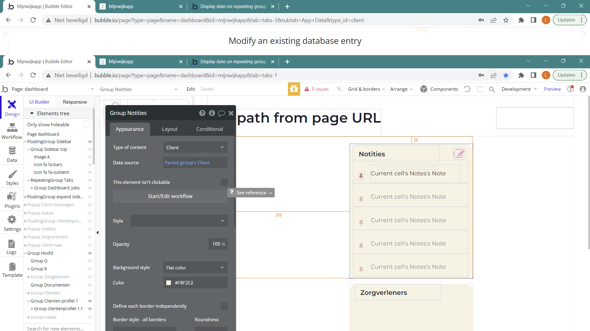

This is how I put the data:
Group
RG
Text
When a new note is added, create a new Note entry in the database, and assign the Client to it in the Client field (of type Client).
You could then also add that note to a list of notes (of type Note) on the client, but to be honest there’s really no need to do that, and it’s not a good idea if a client could potentially have many notes associated with them, so I wouldn’t recommend doing that.
It all looks good… except I don’t know what your search for Notes is (and from your last screenshot, your Note datatype didn’t have a Client field, so you’ll need to add that to the datatype, and include it as a search constraint).
