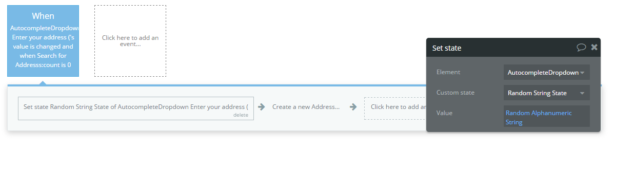

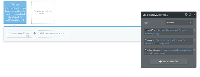

I am trying to display a newly created Alphanumeric string that is assigned to an address. However when i initiate the workflow, a random code that insnt assigned to the address is shown and then 1-2 second later is replaced by the correct code. Below are some images of the set up?
Any idea how i could make only the correct assign code be displayed?

So what is happening here is an interesting corner case. The way bubble works with database is that we perform data operations both on the client and the server, the the part that actually modifies the data in the server side one (for security reasons).
So what is going on here is that 2 calls are made to Blockspring, and they return different random numbers, and the one on the server is the one that is actually saved (which is one it shows up after 2 seconds, since we reconciliate changes between server and client).
So the way to fix this would be to put the string in a custom state on the page and the use this, so that Blockspring gets called only once.
A bit technical, but I hope you see what I mean.

Custom states are just like little post-it notes with useful values on for your page. You can stick them onto (pretty much) anywhere so you can find them later (like real postit notes, put them somewhere you can remember!). So if you set a custom state for a page to your Blockspring ID, it will then be available to use elsewhere on that page and workflows so you don’t have to go back and recalculate all the time.
We use them a lot for things like page state so “edit mode is YES” or temporary lists (users I am selecting to be friends).
In this case you want to set the state as the first thing you do in the workflow. So you are only doing it ONCE as emmanuel says. So instead of doing the API call in the create, you do it first, set a custom state to the blockspring alphanumeric.
Then set your thing’s id to that. Then use the state to display on the screen as well.

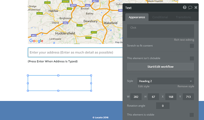

I am however now struggling to display the correct Locate ID in the text box as on screen as below.
Could you please advise how i get it to show the locate ID assigned to the address using the custom state.

So i have managed to create the custom state and selected the page as the element and it does work to create the code in the right field but it still appears to generate two codes and display them both. I can get it to show the client side code only, but not the server side code only.
Joe
I am now officially tearing my hair out ha . I cant seem to find any way to use the server side value. It appears that it still creates two, client and server side. Even with a custom state.
So if you show the custom state in a text field it is the client side one ?
Yes, i have tested this by creating a new text box and having that display the custom state (alphanumeric generation) that is assigned to the element. In this case the element is the input address box.
When i do this it shows the alphanumeric code that is assigned client side, i know this as it is the same as the code that generates first and is then replaced seconds later in the other text box.
It works in terms of only showing one output from the alpanum api. Unfortunately its the first client side version.

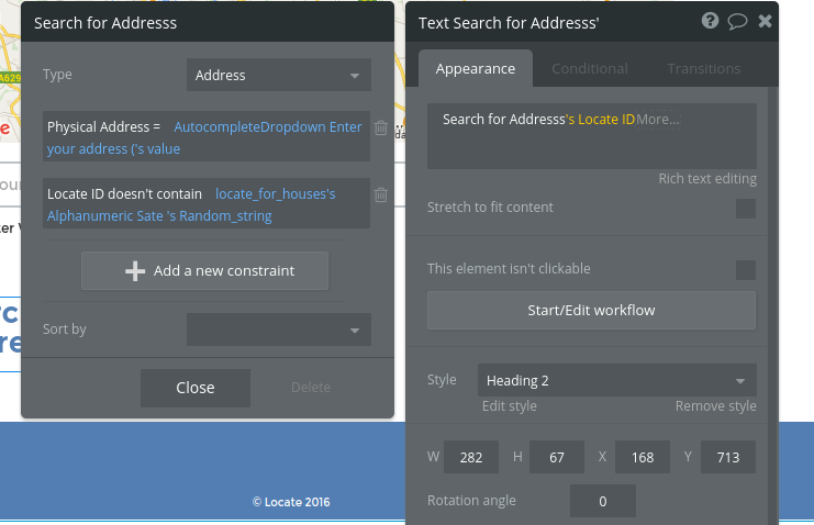

OK, so i managed to get this to work but with one issue, i have used the below settings to show the server side code. Essentially i display the code once the Locate ID field doesn’t contain the alphanumeric state in the Locate ID field assigned to that address in the database.
The problem is that once the client side code is generated it stays attached to the page until the page is refreshed and so when i enter a new address nothing shows. Essentially this means i would have to refresh the page every time a new entry needs to be added. Any ideas how i could get around this?
