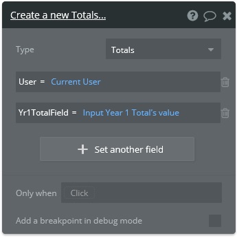

When a new Total 1 item is created, save the current user in the new User field. The action after this should be to make changes to the current user. Save the Total 1 that was just created to the User’s Total 1 field.

I added the next action as ‘Make changes to current user’.

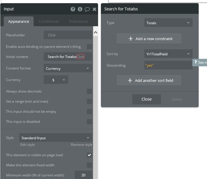

Now I go to the second page and this is where I’m not sure what to do. Adding this in shows what I want but I don’t think it’s user specific. Any other user sees the same total on that page.

When the input value changes, I thought this would add to the database but it doesn’t for some reason.so seems to be falling down there. What am I doing wrong? Really appreciate your help here.
