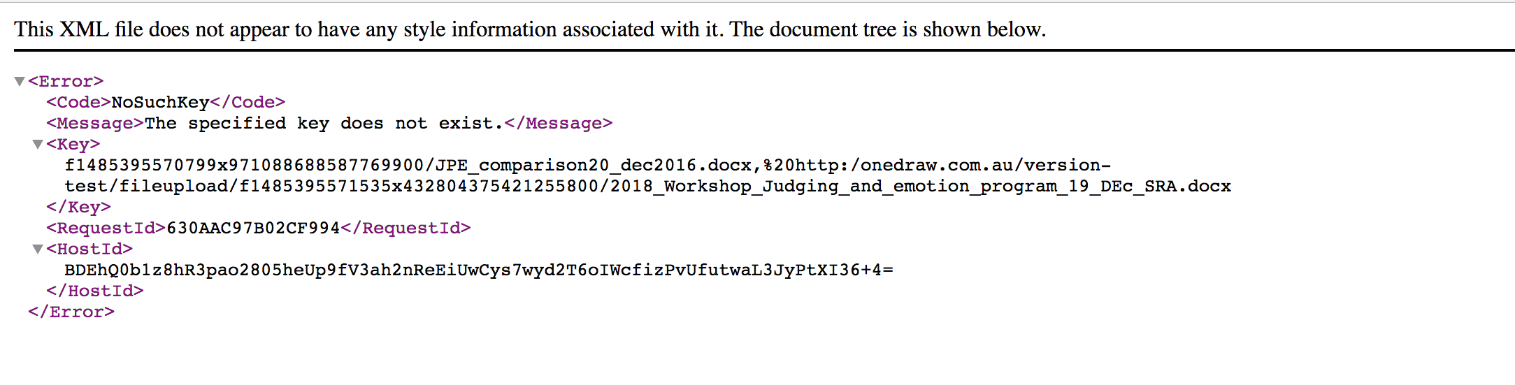

I have had issues downloading files which have been stored in the DB as a list. I have been able to successfully upload and download single files but as soon as there are multiple I end up with a error message. I don’t think it should be too complicated but I cant work out how to tell bubble it is a list it should be finding for download.

Error Message Example:
I’m just guessing here, but it looks like technically, you did download the list. The list is a list, a file is a file. If you’re asking to download the list, you’ll get the list that references the files, but not the files themselves. I think what you’re asking to do is to download all the files within this list. Is that correct?

Yeah exactly I’m trying to download all files which have been uploaded together as a list in a data field. Currently it works only with single files.
