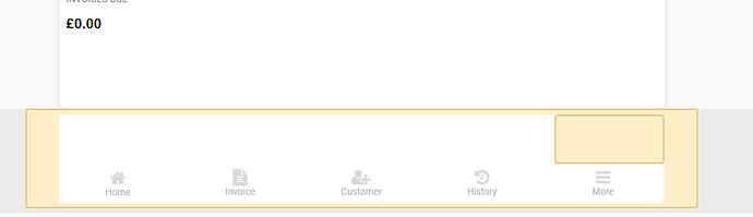

Floating group

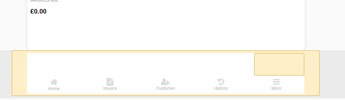

And when I click on ‘More’ the 5 links get pushed down to reveal the popup box, but I want the links to remain in place and for the popup box to open above the links!
My best solution for the bottom nav bar for now is to put the popup box (orange) in a group which does not collapse when hidden. The orange boxes are only shown when a link icon is clicked. This means the popup opens above the link correctly but it also means the bottom nav bar needs to be extra tall.

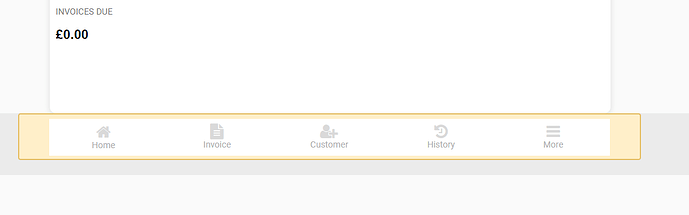

When I do this my nav links disappear below the fold. It’s as though shortening the repeatable element (which is inside a floating group) simply pushes it down.

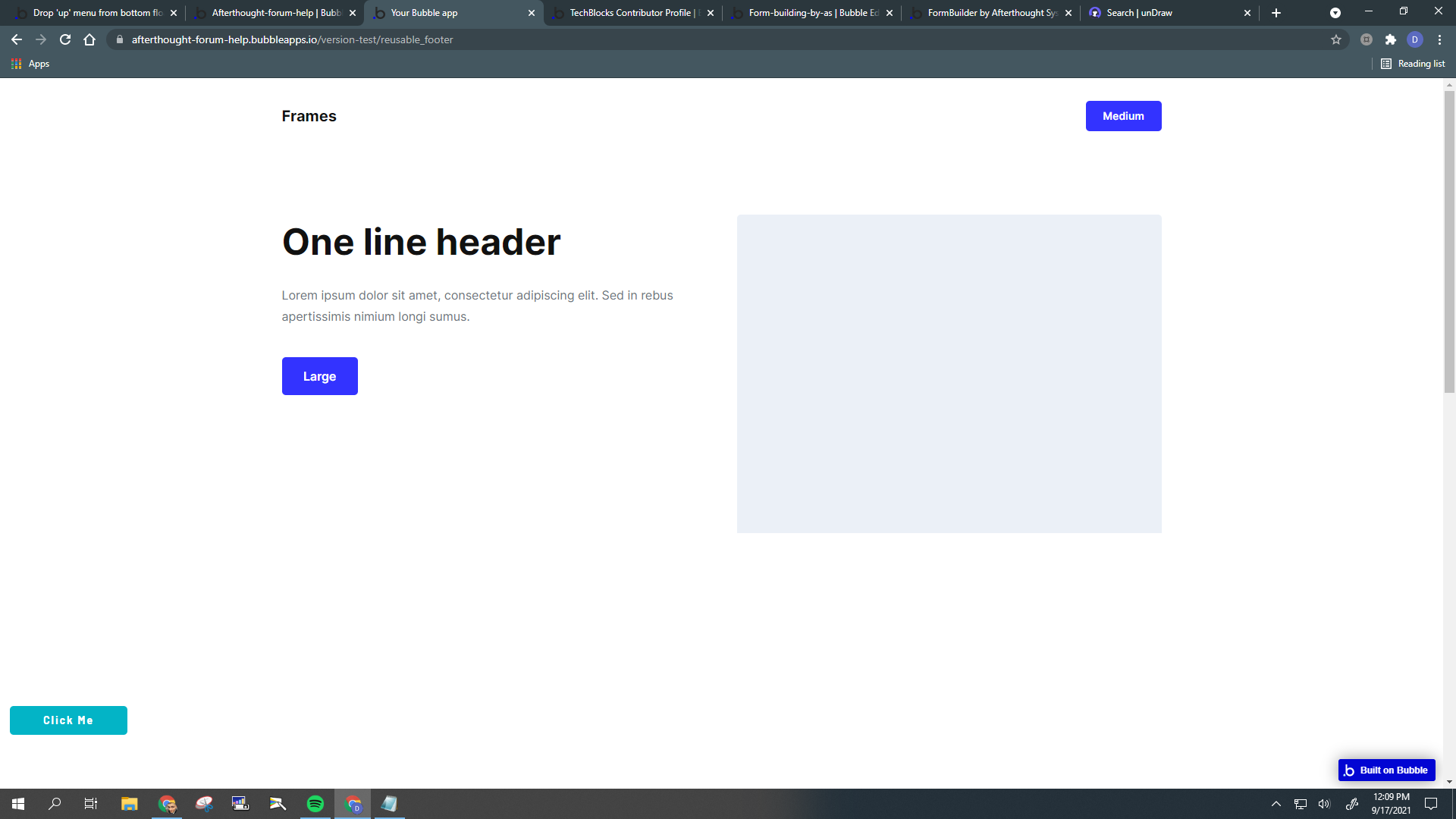

I just put a button on the “footer” that says click me - That’s my makeshift example footer.
Your button is viewable in the editor but not viewable in preview mode? Sorry, I appreciate your help but I can’t see it.
That is weird.

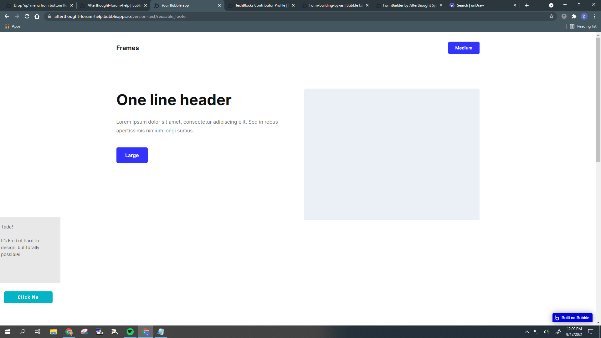

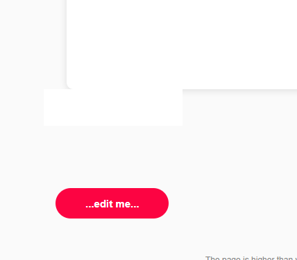

There is how it looks, I was able to use a Group Focus in the reusable element successfully without changing the height or width of the element itself.
Very weird, I really don’t see it. But, I am going to look at how you did it and try. Will update! Thank you.

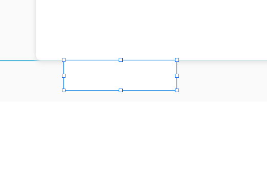

OK, I see what you did and I think it ‘appears’ to work but if you create a horizontal line and have your button flush underneath that line, you will see that there is a white space created above it which is the size of your text box.
I have the Group Focus flush under the white page border as below.
But it displays like this;
All this said, I think the Group Focus has one very good advantage over a normal group in that if it overlaps any text links, those links still work. This means I can allow the Group Focus to be high and eat into my page because it won’t prevent anything else from working. So, thank you for the heads up on Group Focus as I hadn’t used them before!
