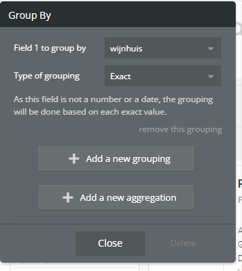

When you click on grouped by, did you set up the grouping there?
Hi,
Sorry, don’t know what you mean by that, set up the grouping there.
Sorry, Dirk
Literally click on the words grouped by in your screenshot and share a screenshot of the window that appears.
Hi,
Oke, yes I did.
Cool… I should have known from the other screenshot that you had set that up… sorry about that.
