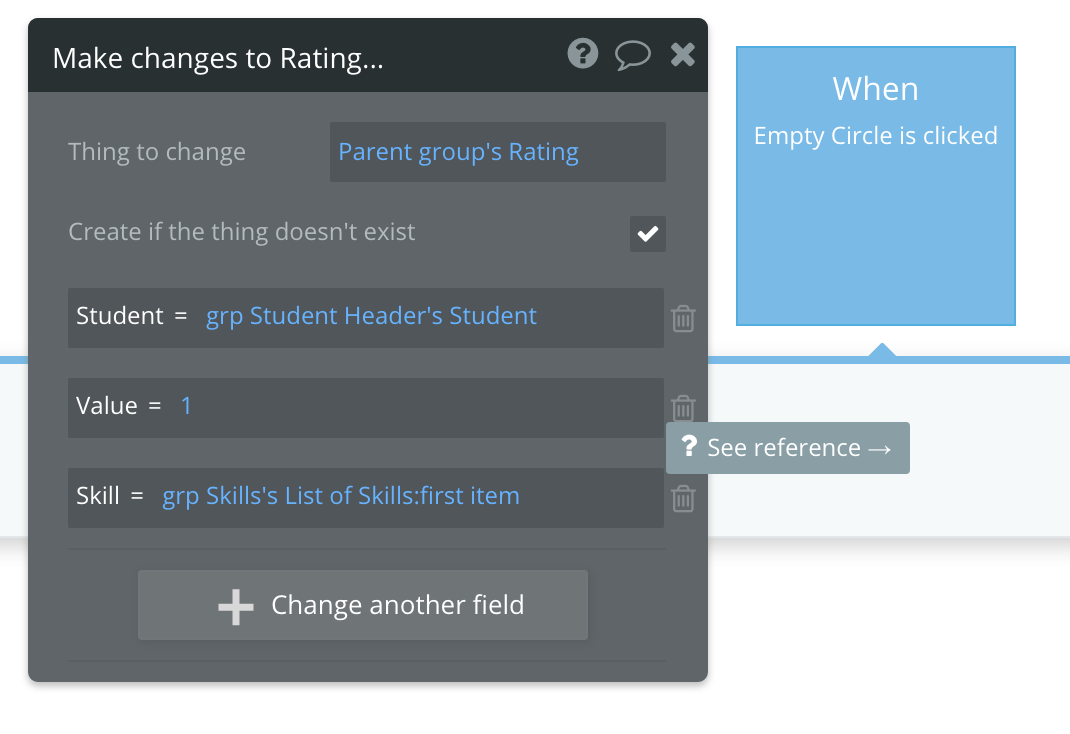

Here’s a snapshot of the workflow. The part that is not correct is the last field on the Make Changes to Rating dialog box. What is currently happening is I click a circle, and it updates the first Rating in the list. I understand why it is doing that, but I don’t know how to make it not do that lol. Thanks for looking.
There are a few people in your app right now, but I think the solution is actually you don’t need to update the skill field. It’s already defined in the rating you’re making changes to. Remember you set your source of the ratings group to be of only that cell’s skill. So it’s already there. I removed that field change in the workflow, so try rating now.
Hm, doesn’t appear to be working. Maybe my thought process was wrong here. There’s a Repeating Group, which consists of a list of Skills. In each Cell, there is a Rating. Doesn’t the Rating still need to have a Skill associated with it? My understanding is that until the Rating is created, it cannot have a Skill associated. The first time a teacher rates the student, it would create a Rating for that student for that skill, that’s what the workflow action was attempting to do.

Yeah, I just realized there’s a few groups going on… standby, I’ll update in a moment.
I’m not sure what you did, but it works now. I’ll do some reverse engineering and scope it out, but thanks for your help! The community here is pretty legit, thanks to everyone who took a poke!
Ok, I think it’s all fixed up now. You should reset any test students or just create a new student to see the update.
So, the group with the ratings circles is actually now not in a ratings type group. It doesn’t even need to be in one - you’ll see what you need is really in the conditions on that “ratings exist” text. It’s in a group now so that your placement/alignment is still what you had but the type is now skill because we still need to know what skill the rating text is in reference to. If it wasn’t in this group it’d still pull the skill from the cell it’s in, which is already type skill.
This solution solved a chicken or egg thing that was happening. Take a look at the workflows to see how that was resolved and let me know of you have any questions!
