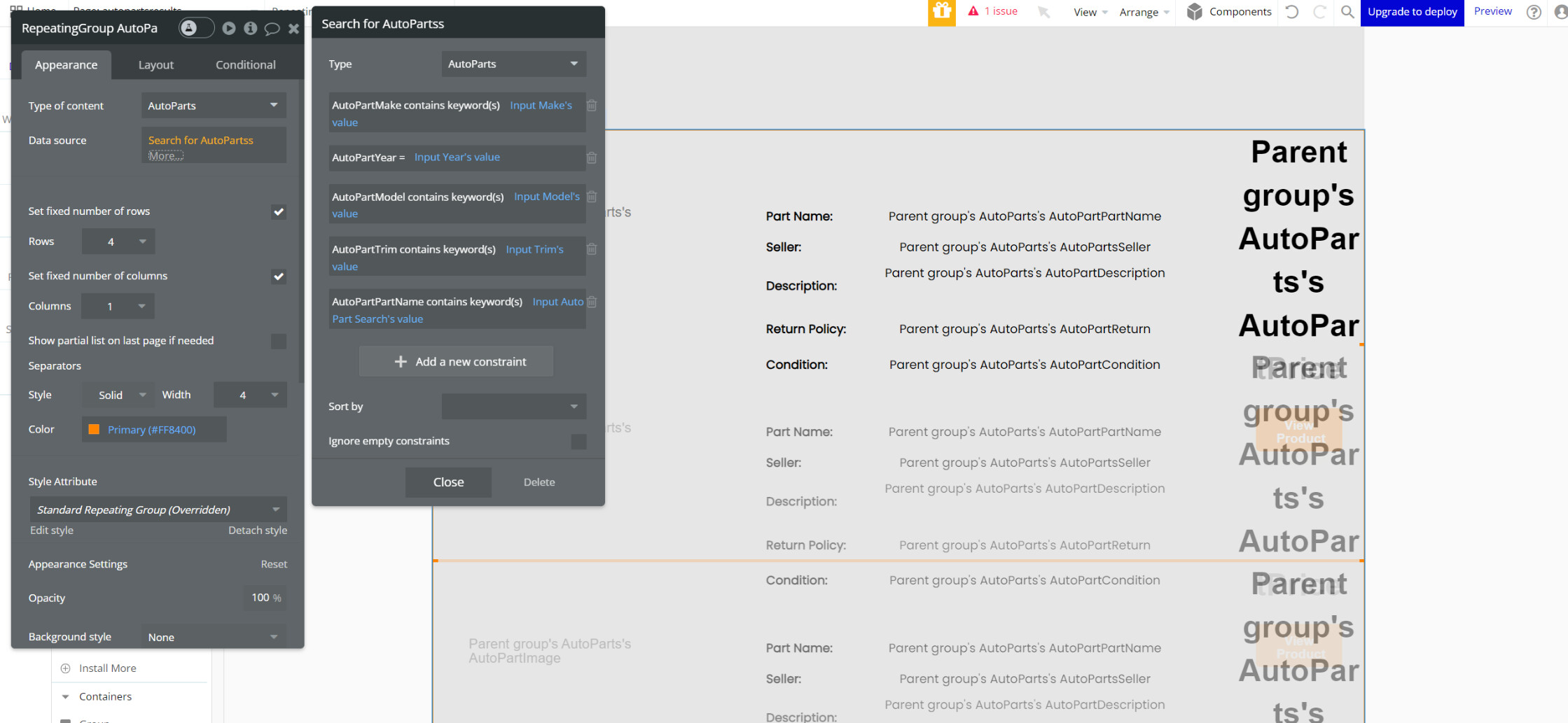

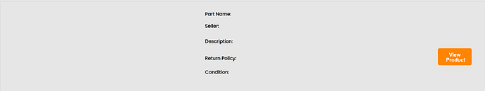

I am trying to make a repeating group show dynamic text, but it isn’t working. The static elements show, but not the dynamic ones.
Any help would be appreciated. I’m on a very tight time schedule and am severely stuck. :slight_smile:
Here are some screenshots.
it looks like you’re forcing filters to be filled. Try checking “Ignore empty restraints”.
Still no luck. This is what’s being returned.

is the source set correctly for the group containing the details is each cell? I assume each row’s contents are grouped in a group of type Autopart, but do you have any smaller embedded groups? are the part name: value grouped together for example? check the debugger it can tell you where data is not being fetched

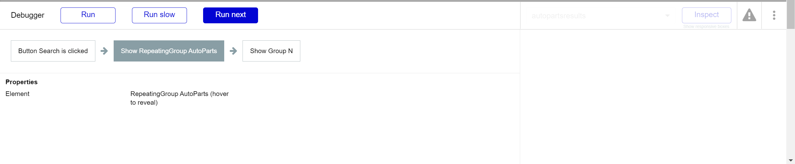

The debugger doesn’t say anything about Data being pulled. I am fetching data as shown in this guide.
Debugger:

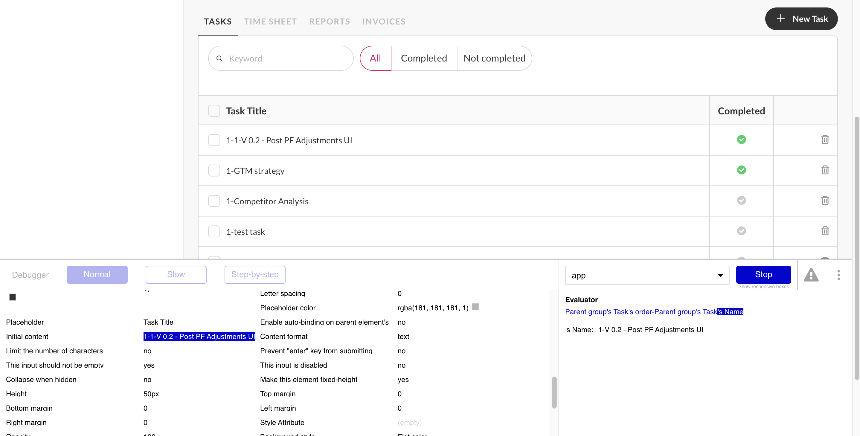

if you click a dynamic text you can inspect whether data is being pulled on not, like so:
  1. if it shows as empty, then data is not being pulled and data source needs reviewing,
  2. if is shows correctly then the problem is in layout or privacy, and e know it’s not privacy so it may be that text layer dimensions are too small to show the text.
