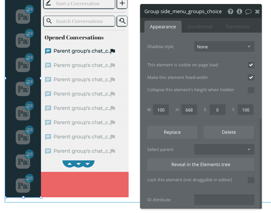

Would anybody have an idea why this would be happening? In the editor the elements are lined up correctly and sized correctly.
But on page view the elements are different heights or something that causes the red group to be slightly higher off the bottom than the dark blue group on left.

Did you try checking the box where it makes the item a fixed width? Another work around is applying a group to it and making the item and group a fixed width

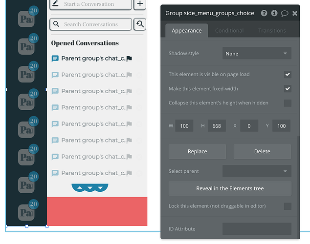

I think I know what the issue is… click on the left dark blue bar and send me a picture of the editor pop-up window and then do the same thing for the darkblue bar on the right
Thanks…I fixed it. What a pain in da butt…these things always get me because I can’t stop obsessing over finding the answer.
Turns out it was the text element for groups on the left side. The text line space caused the text to get pushed below and out of its designed height dimension (ie: text element height is 40). Seems like instead of making the text not viewable on page, it caused the elements to adjust height to accommodate the text element.
