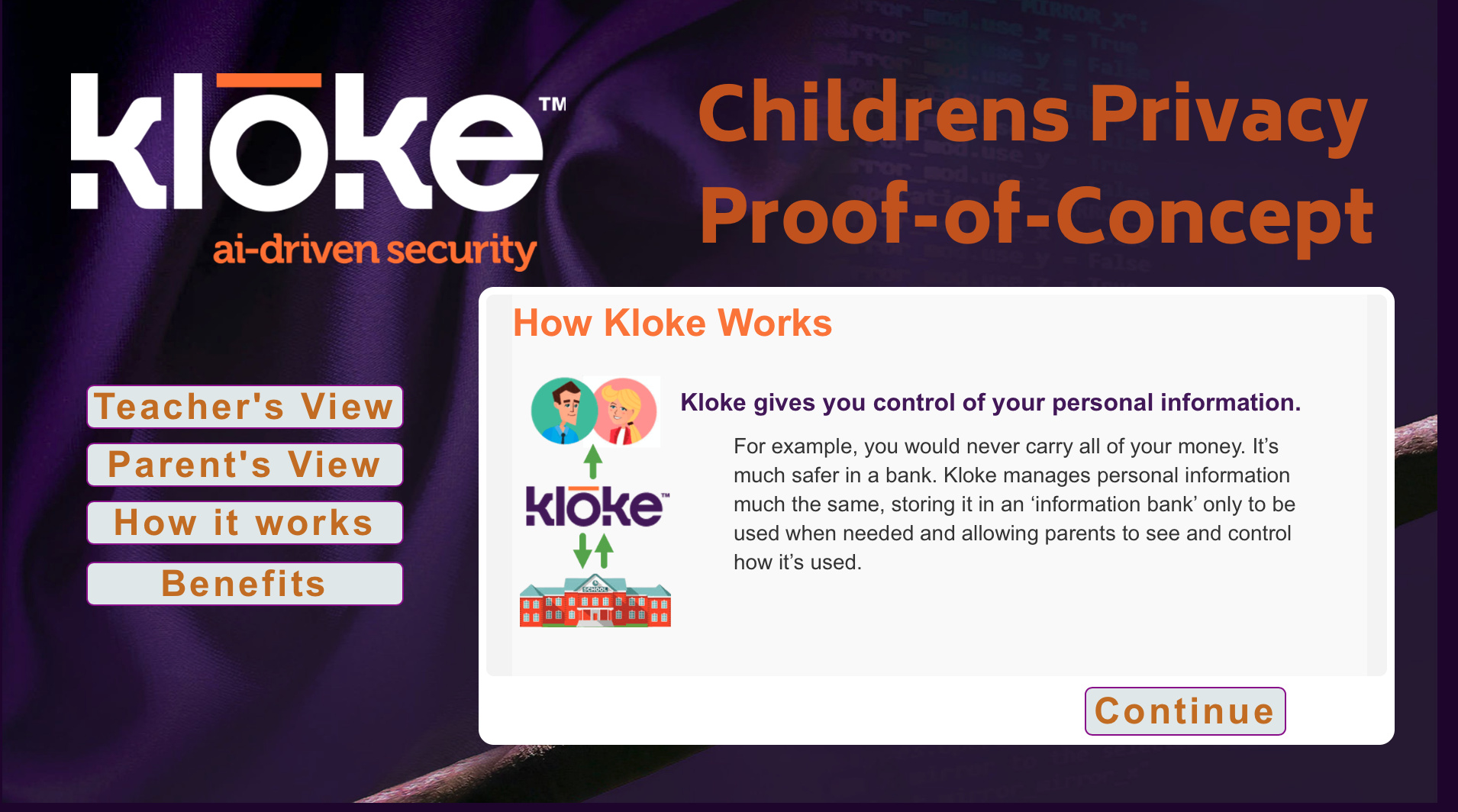

First panel is perfect. So I press the button…

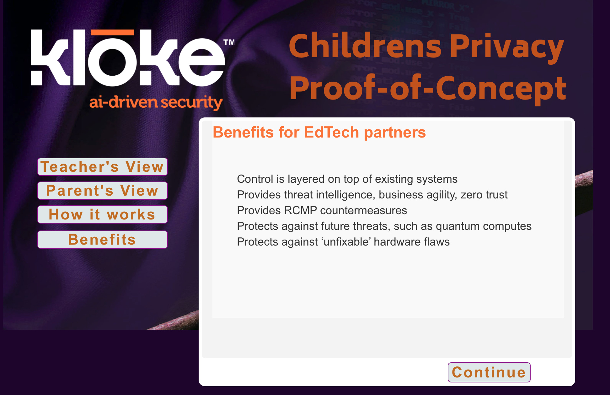

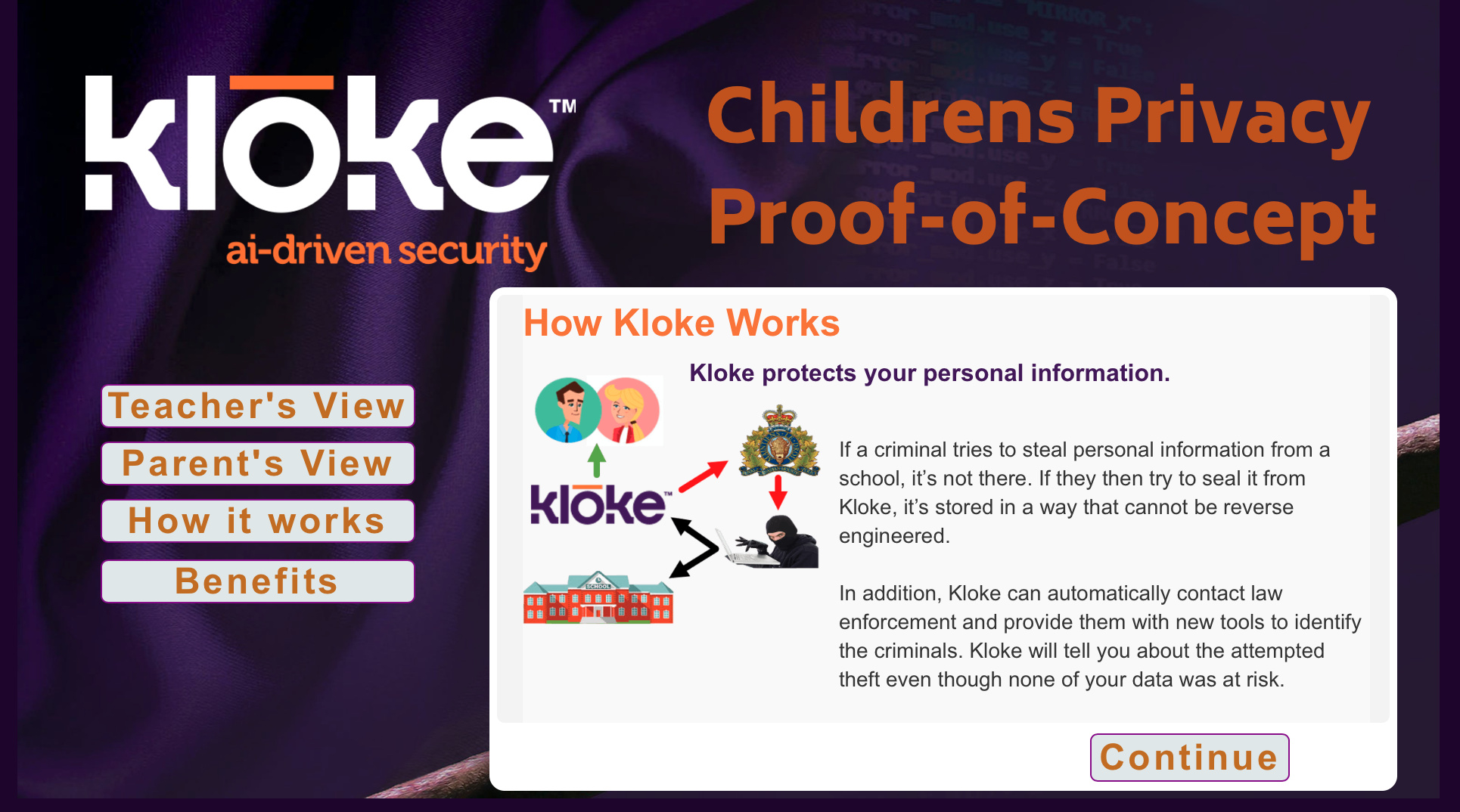

now the reusable element is bigger.

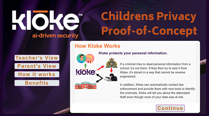

after 5 clicks

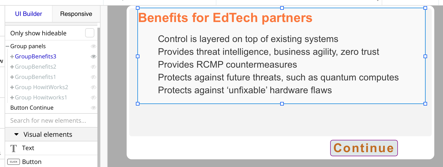

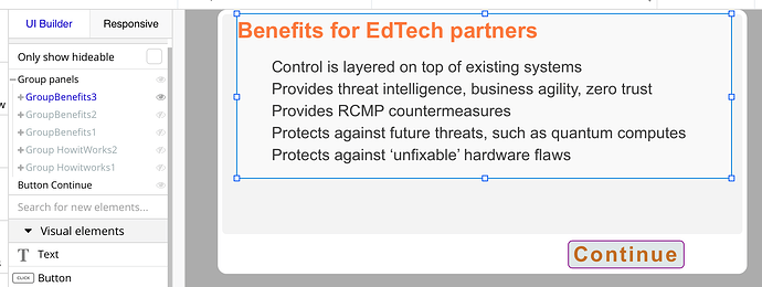

here is some of the panel and groups
Not sure what else to post to figure out whats going on

The mistake you are making is NOT stacking the groups under each other with 0 px space between them. The groups should be stack underneath so you could see and edit them all at once in the editor (not picking one group, and then hiding it and picking another)
@hirscr Did you figure out the solution? I’m having the same issue
I think bartek had it right. I did fix this, and I think it needed to be fixed byu having the groups that were on top of each other be positioned with 0 space between them I don’t know why that should have worked, but I did get it corrected
