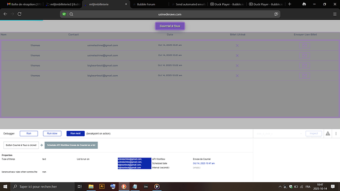

Hello I have emulated the workflow on this video https://youtu.be/LLYaNHmt6_Y to make an email blast but I can’t seem to activate my workflow. This is my system
Btw note that “Courriel” means email.
so it does see the list to send but then nothing happens, the workflow does not seem to be triggered.
What am i doing wrong?

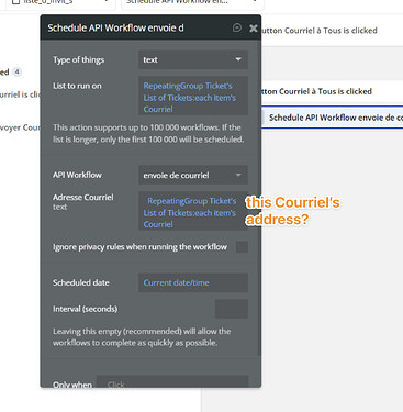

Things I would check:
  • do you have the email keys setup properly? Can you send 1 email to 1 recipient?
  • are the backend workflows not paused?
  • also, could your on a list workflow be incorrect? I think you’re looping over the list of email – ok – but then on each pass you’re trying to send the entire list again.
Hello, I have added this
but so far, it does not work

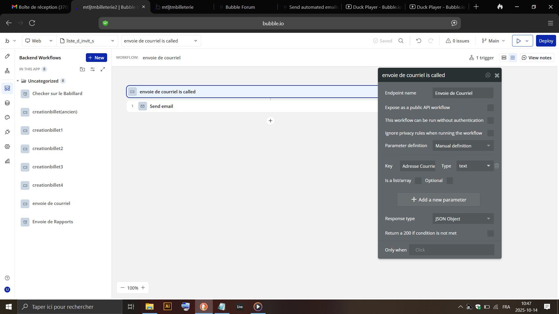

SOLVED - omg so the email does not send if you DON’T put an object….
QUESTION : now the Email Blasts is sending 1 email per adress but sometimes the same email adress is repeated many times. Any tips how to curated the list of duplicates?
