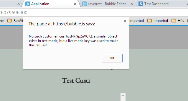

I am trying to test my App Live, so that I can do some testing on Stripe.
However when I try to move on from payment I get the attached error.
I created the customer as part of the flow on Live so not sure what is happening
Any clues on what is happening?
Its ok…I have worked out its a Stripe error not a Bubble.is error
Right, it’s very likely an issue with the keys you’re using, mixing live and test.
Ahh no…ok so not an error on Stripe
I am using payment workflow -> Collect Users CC Card information.
I thought that would charge the customer, but it doesn’t, that just wants to save the info that was input so it looks for a customer on Stripe…which I didn’t have…that was the error message.
BUT…I need to charge a customers debit card not just save the info…I cannot see how to do this?
Collect a user CC info means collects the card info, not charge it. See here https://bubble.io/reference#Actions.ChargeUser. What you need is ā€˜charge the current user’ i think.
Also, the error message you showed is coming from stripe, that means you’re using the live keys in test mode.
Yes the error message was from stripe telling me that the customer doesn’t exist in live but it can find it in test, but I am accessing Strip via Live…which is correct as I am testing my Live App.
