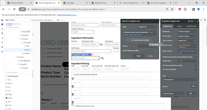

Im clearly missing something. In the workflow I am referring to another dropdown, as I have a number of times, even within this flow and it wont go blue. I have even deleted the dropdown and tried again. The field in the DB is text, Ive double checked.
Im sure it obvious to others but can someone point it out please.

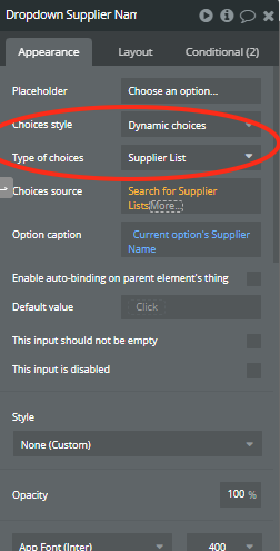

In your screenshot, you show that you have the dropdown datatype set to type ‘Supplier List’ - so that would be what datatype you’d be referencing if you’re pulling from that.
The ‘blue’ dynamic expressions you’re attempting to get into nested territory, where you’re referring to a ‘Thing’s thing’, for example, a Dropdown’s Supplier List’s Company Name; the important thing is the data you’re referencing matches the data you’re setting. If you include a screenshot of how your database is setup, especially Batch Ingredient, and Supplier List, that would be helpful.

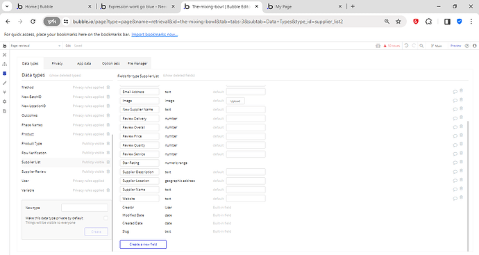

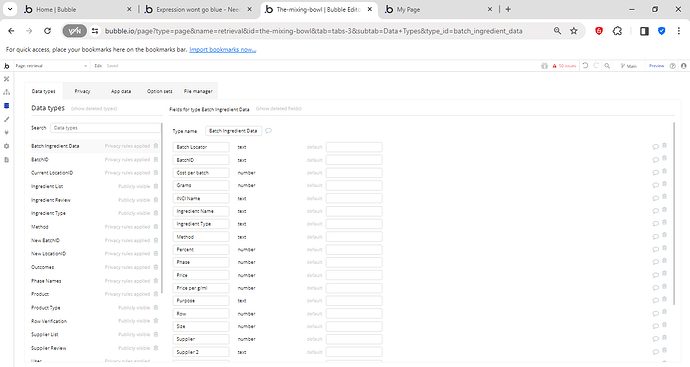

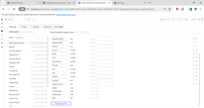

Heres some screen shots
I doubt Im well set up, this is like the first real app Ive worked on. I have a little experience with DBs but they have all been set up.

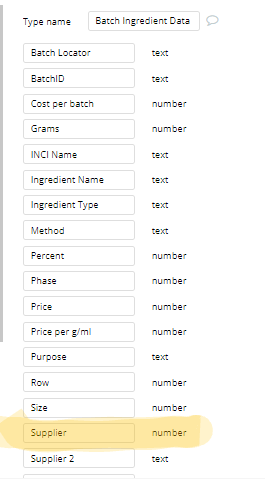

Here’s your issue:
1000035208
Bubble is a relational database; these relationships are built by linking datatypes.
On your Batch Ingredient, you have a field called Supplier, set to type ‘Number’. What this should instead be is a field called Supplier, set to type ‘Supplier List’. In Bubble you can’t edit these datatypes once they’re created, so instead you’d need to delete the Supplier field, and create the new Supplier field with the proper Supplier List datatype.
Some of the benefits of linking data this way is it forms a 2-way relationship with your data, allowing you to change a value in one datatype (let’s say if you had to change a Supplier’s name), those changes can be carried through the app.
Cheers mate, Ive been looking at supplier list and not ingredient. Thanks for sticking with me
