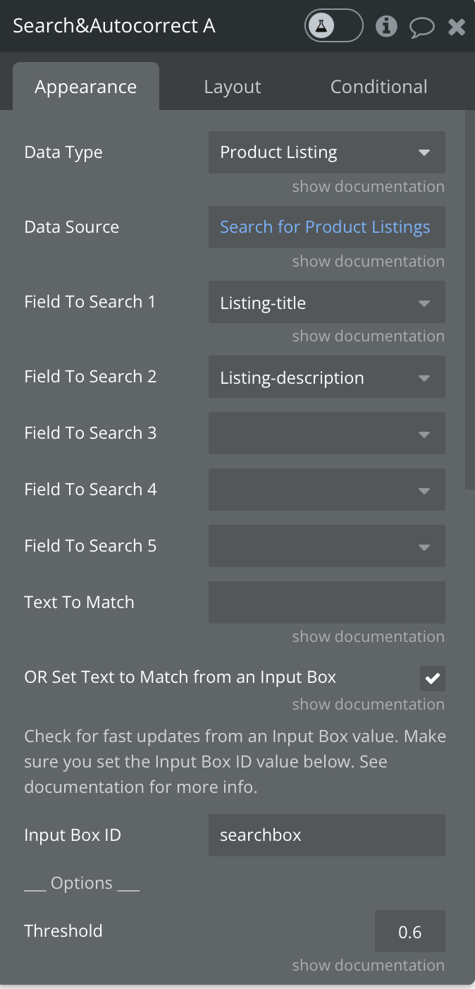

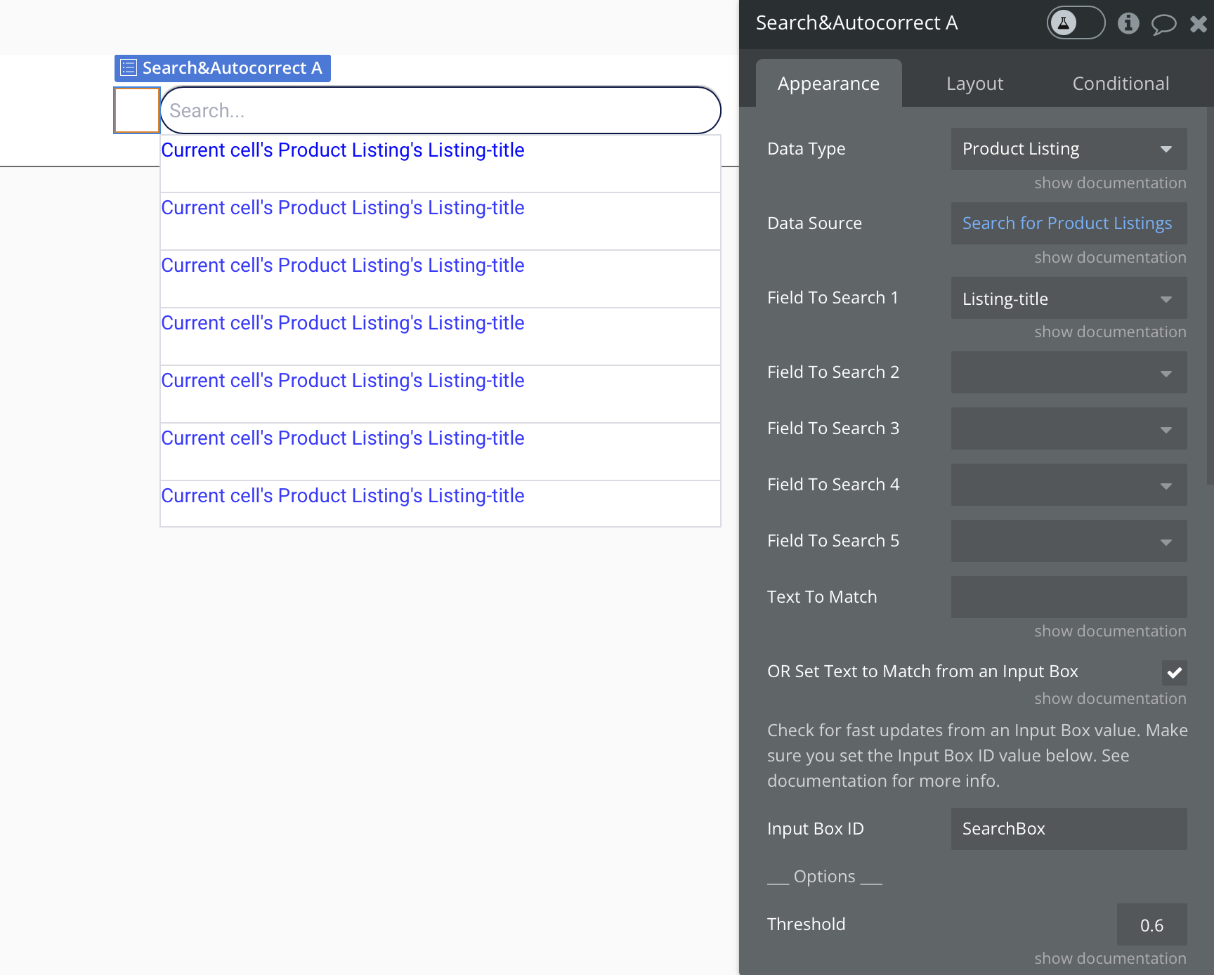

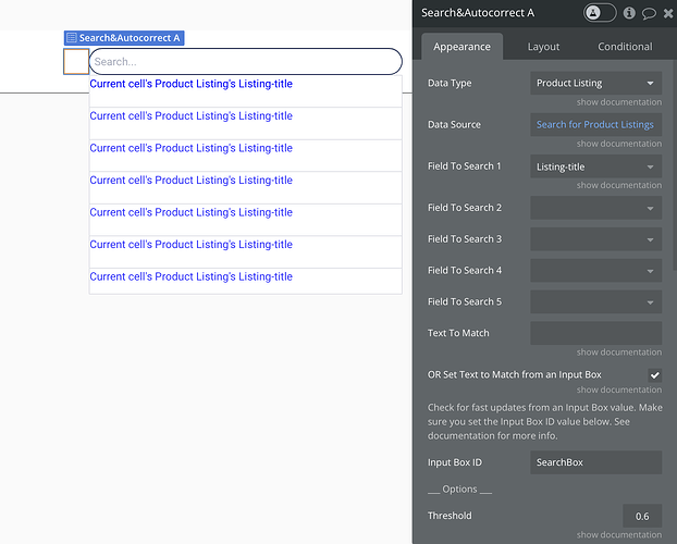

Search&Autocorrect A:

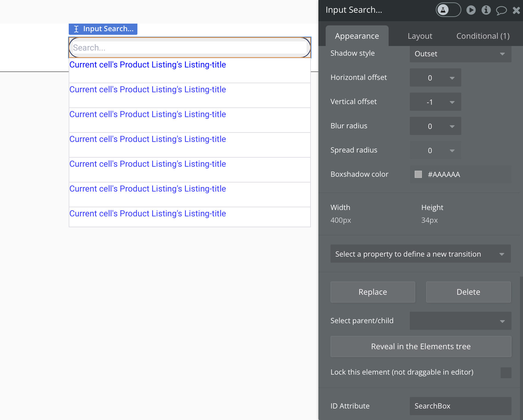

Input Search bar:

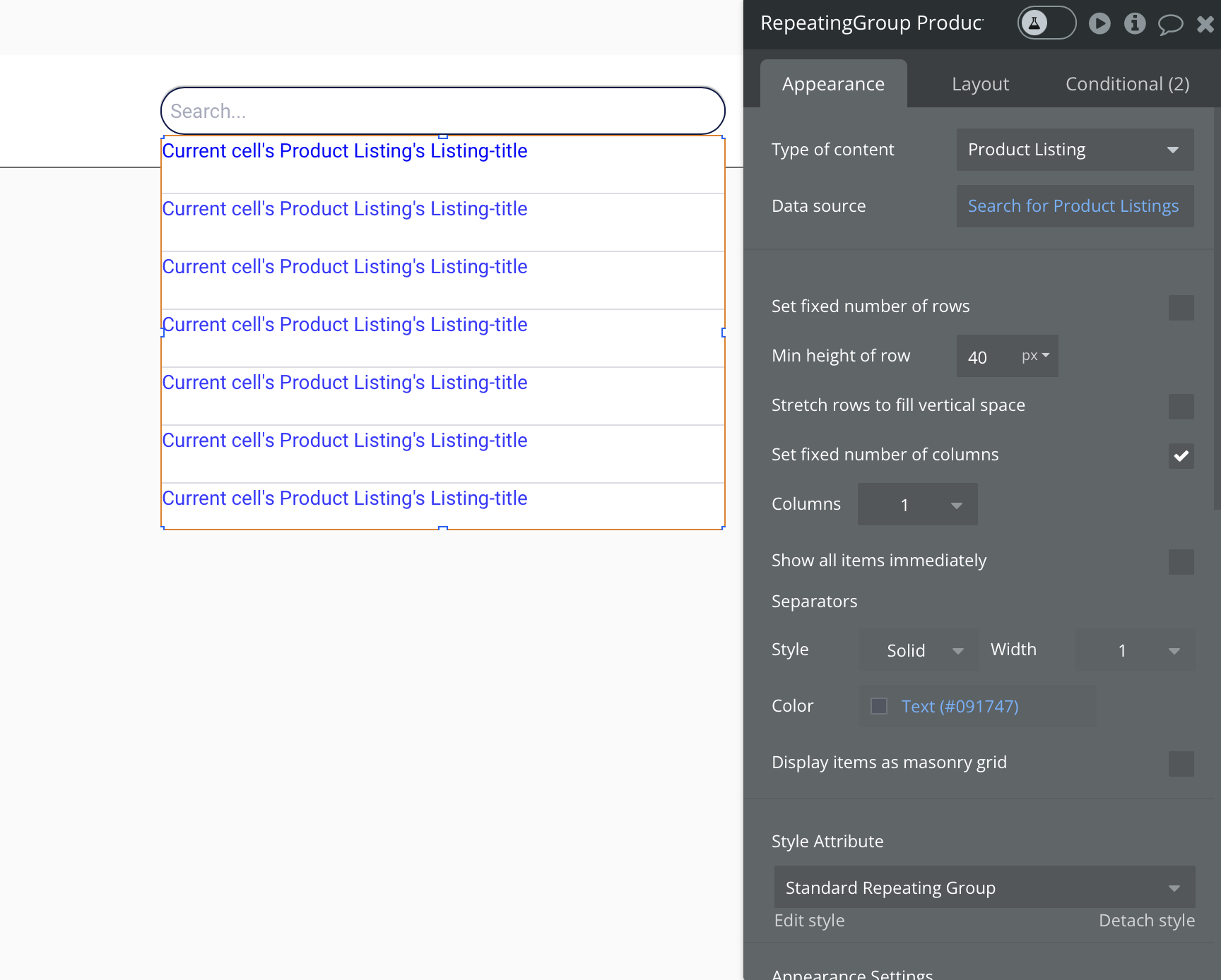

Repeating Group:

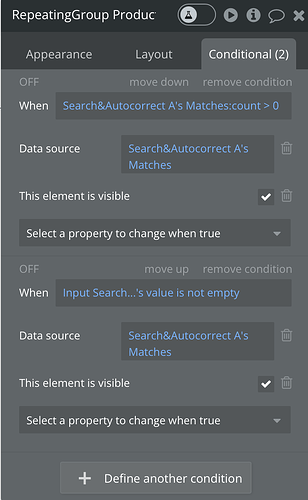

Repeating Group conditionals:

try using all small letter for input box ID, This method will consume large WU as every time you press a key, a search is happening.
uncheck this

It seems there’s an unexpected issue since, on our end, a similar setup is functioning correctly. Could you please use the Inspect tool to verify if the plugin is receiving data from the database? After doing this, try searching for something by typing in the input element and then inspect the plugin again. You should see the data reflected in the “Matches” state. Additionally, could you let me know if you’ve set any specific conditions for fetching data into the plugin element?
Regarding linking the input with the Fuzzy search plugin using IDs, it’s important to keep the “set text to match from an input box” option active. If you decide to uncheck this option, you’ll need to specify in the field above which input element’s value the plugin should use.

I have not changed anything from my previous screenshots, plus here is a screenshot of the lower portion of the element (ID Attribute empty for the search&autocorrect element).

Thank you for confirming that the matches are visible in the plugin element. Since this is the case, we won’t require the screenshot of the settings below the “Threshold” field. It also appears that the conditionals for the repeating group are correctly set up from the screenshots you have sent.

It works!! I had to put a workflow for the group focus to show.
