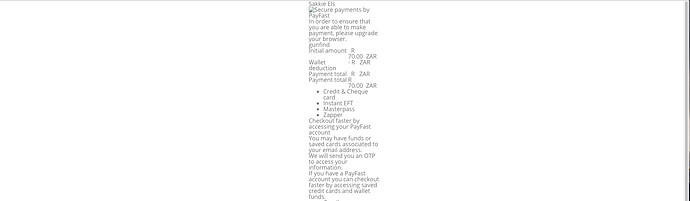

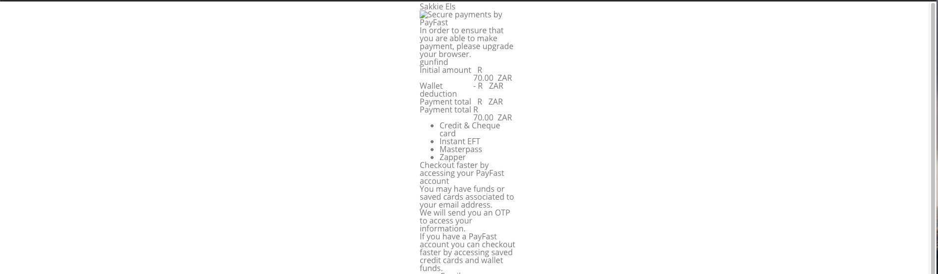

The HTML element isnt rendering it correctly.
I assume bubble saved the html response as a giant string. I would need to parse it to get rid. of the starting and ending quotes on the string?
Try display as iframe
