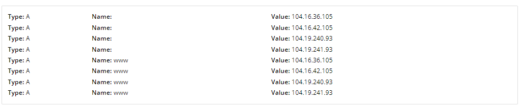

bubble is telling me I need to add four records that are Type A www records. Godaddy is telling me I can’t add another record with www
What am I missing here?

Why does you godaddy say that? I could add 4 in mine. Maybe there are existing ones before, and you need to remove them?

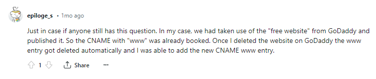

There is this info on the web: Reddit - Dive into anything
If you received free website or hosting from godaddy, maybe it doesn’t let you add other ones.
This was exactly it. Had to delete the “Free” placeholder website
