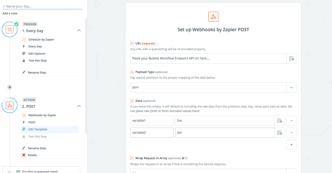

@topherwilliams I use the method @csblack talks about.
Have Zapier trigger a zap every day at 5pm. The action of that zap should be a webhook that triggers an API workflow inside Bubble which can then the email to user/users.
Zapier will make it very easy and will tell you if things have gone wrong.
You can always bring it “in house” at a later date.

@topherwilliams Should look like this:
Got it. This is how you set up Bubble to accept API/workflows correct?
Also, for any other beginners following. Here are the URLs that you would put into the URL section of Zapier: Introduction - Bubble Docs

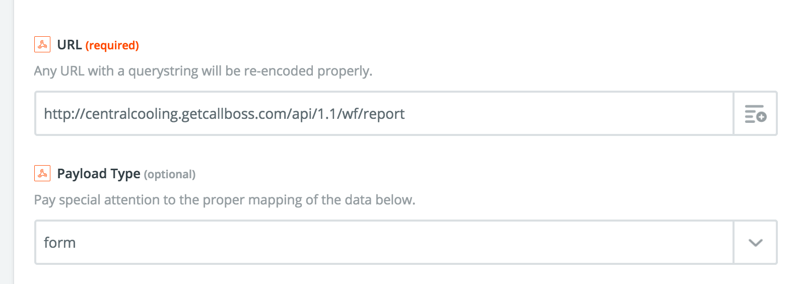

I’m getting an error on zapier when I test the URL.
I guessed it might be because the URL didn’t exist you (or something like this).
So, I tried to create it in bubble. Here’s what I did for that (this might be incorrect too, I just guessed)
I’m still getting the error on zapier. Any idea?
Since it’s returning a 404, that must mean that the URL of the webhook doesn’t exist yet. However, I’m not sure how to set this up within bubble.
Have you deployed to live yet ? Otherwise you will need version-test in your Webhook URL
Thanks. I caught that one when trying to troubleshoot.
Here’s the current URL I’m using in Zapier: http://centralcooling.getcallboss.com/version-test/api/1.1/wf/report
Do I need to set up a “report” endpoint is specified in the zapier workflow URL within bubble to accepts the POST? Or should it work?
OK, figured it out. I was using the wrong field type in the API Workflow. You need to use the “create new end point” and not the “recurring” event.
@topherwilliams - Also, not sure if it’s a dealbreaker - but Payload Type in Zapier should be JSON
Thanks. Just changed it. It will be running a test at 12pm EST so I can confirm it works!

Hey @andrew1 looking at the post above, looks good… I’m getting hung up on how to transfer my variables to bubble? It’s not really making sense for me.
Any advice on how to get started here?
For reference, I have an application, in which users are emailing X amount of people automatically, from a list of XXX amount. Ea day, I’d like the emails to continously grab X from the list and add them into the rotation.
Currently, I can get 1 off sends/lists started, when the user logs in to push the button… but I’d like for this to happen automatically… As it sits, I have a zap set up that looks like above… but its not triggering any actions… Also - when I try to add “data” like “user=user” its telling me I have invalid inputs.
Any tips on how to go about this woudl be great!
