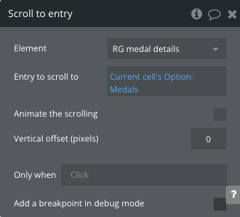

Here is the workflow i tried to use to make the other RG scroll to and entry that is the same as the current cell of this 12 cell RG:

Basically, why is my workflow step not working?.. currently, the single cell RG just displays the first option in the set no matter which of the 12 cells i click in the other RG

‘Scroll to entry’ is a scroll action… (i.e. it’s for actually ‘scrolling’ to a position in a repeating group that contains a number of entries)…
If I understand your question correctly, you’re not trying to actually ‘scroll’ to anything here, you just want to display the details of a particular Medal from the first RG in the second RG, yes?..
So there’s no need to use a ‘Scroll to entry’ action (you only have 1 entry on your RG, so scrolling to an entry won’t do anything, as you’ve discovered)…
Firstly, is there a particular reason you’re using a RG to display the medal details? (it only has 1 cell, so a regular group would be simpler)…
If you use a regular group in stead of a RG all you need to do is use a Display data action to display the relevant medal details in the group.
If you insist on using a RG, it’s slightly more complex… you’ll need to change the datasource of the second RG to display only the selected item from the first RG…
There are a few ways to do that…
You could set the RG datasource to be the current cell’s medal, converted to list.
You could set the RG datasource to be get all medals, filtered, then use a constraint to match the medal to the current cell’s medal…
You could set the RG datasource to be get all medals medals, item number: current cell’s index…
But, surely the simplest way is to just use a regular group instead of a RG and use Display Data to show the current cell’s Medal (unless there’s some particular reason you’re using an RG here, or something else I’m missing)…

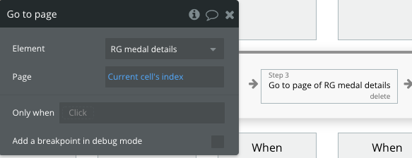

Yeah you can’t use show next item , as your datasource only contains 1 item (so there is no next item)…
If you want to stick with using a RG, and have the ability to go to the next and previous item using the Show Next/Previous actions, the best way will be to use a Go To Page Action instead of a display list action…
Keep your original datasource for RG2 as Get All medals
Then, when an item in RG 1 is clicked, use the Go To Page action on RG2, with the Page being the Current Cell’s index.
So i’d have to have a seperate page?
No… ‘Go To Page’ is an element action for repeating groups (as well as a Navigation action):
It will show the specific ‘page’ of the RG…
as your RG only has 1 cell, each page only has 1 item, so ‘go to page’ is basically the same as saying ‘go to item’, whcih I think is what you were trying to do originally with your ‘Scroll To Entry’ action…
The only difference is you have to give a page number (rather than an actual entry), for which you can use RG1’s current cell’s index.
Ok thank you for your patience that sounds like it should work. i’m going to give that a try now i just need to get my head around it.
Ok, so when a cell on RG1 i pressed i do this
Screen Shot 2022-08-31 at 7.11.11 pm
and now when the arrow on RG2 is pressed ‘show next’ is now working!
