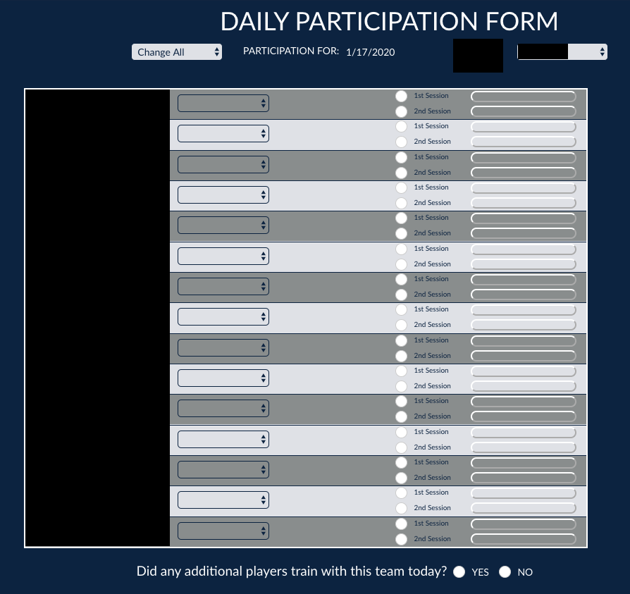

I am trying to create a form using repeating groups. That part is done. I have the input fields auto-binding to the DB. The staff has to fill the form out daily, and would like the ability to auto-populate the form with yesterday’s data from the DB, and have a Change-All drop down outside the form. The Change-All dropdown form contains the same Option Set of options as the dropdown list inside the repeating group. Ok, I will walk through the workflow. I apologize, but cannot share an editor as it contains some protected info.

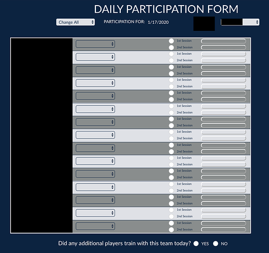

When page loads:

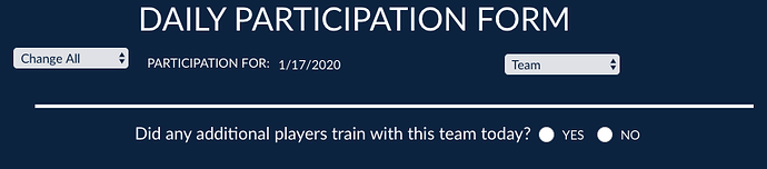

The user selects which team they are filling the form out for from the dropdown on the right. The data source of the RG changes on that action, and the list of players load into the RG:
If you select the dropdown in the RG, it auto binds that to a DB thing. Same if you select the 2nd Session radio button. The two empty inputs on the right are just me tinkering with different potential solutions.
Problem #1: When the Team is selected from the dropdown, I need the DB value from yesterday’s training session to populate the dropdown in the RG.
Problem #2: If the user clicks the Change All dropdown and selects one of the input options(Option Set from DB) I want that to overwrite all Dropdown inputs inside the RG.
Any help would be greatly appreciated, I have been stuck here for a couple of days. I am wondering if there is a way to create a Custom State for each option in the dropdown list, and then change the state of the group inside the RG to match the State of the Change All dropdown. I am unsure how to pull this off, but I think it could work. Or I am way off and you all will save my sanity! Thanks in advance!

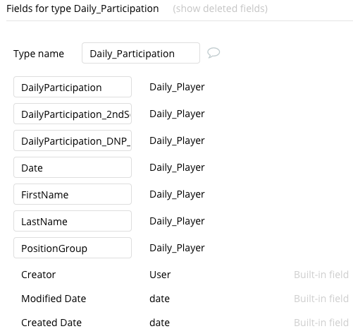

Screen Shot 2020-01-17 at 2.32.50 PM

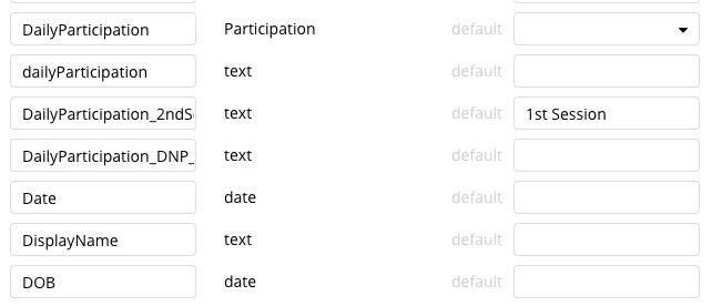

Daily_Player has 66 Fields and Daily_Participation has 10:
Screen Shot 2020-01-17 at 2.41.34 PM
So all data is stored in Daily_Player, and I am planning on leaving it in the Bubble DB for 30-60 days depending on size and speed.

Does all of your data wind up in Daily_Player?
Right off the bat it looks like every single one of your data types in Daily_Participation is the custom type Daily_Player. This is roughly equivalent to a ‘foreign key’ to use SQL terminology. Unless you are doing something something very strange with your database architecture, I doubt this is what you want.
In your picture:
  • The field (column) Date points to another thing (row) in the Daily_Player type (table)
  • First Name points to another Daily_Player row.
  • Last name points to yet another Daily_Player row.
It’s not clear what daily_participation is trying to do here. It literally holds no data of its own, which isn’t inherently wrong, but based on what you’ve got here and your questions, I’m almost certain that’s not what you want to do (or if you need Daily_Participation at all).

Thank you for your response, and you answered one of my follow-up questions about field type. To answer your MJ question, yes, there is a single daily entry for each player upon submission of this form. Here is a snapshot of the Daily_Player DB, it is set up with the expected values, except the duplicate DailyParticipation which I was tinkering with. I didn’t know if those alternate Data Types being available would somehow sync a “Like” field across multiple tables. I am obviously new to DB architecture, but upon your explanation absolutely understand the error of my ways! I really appreciate you taking the time to look at this!
Screen Shot 2020-01-17 at 5.09.51 PM
