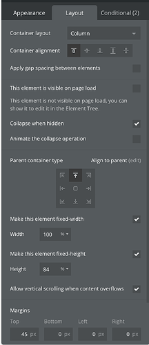

the column group containing the rg:

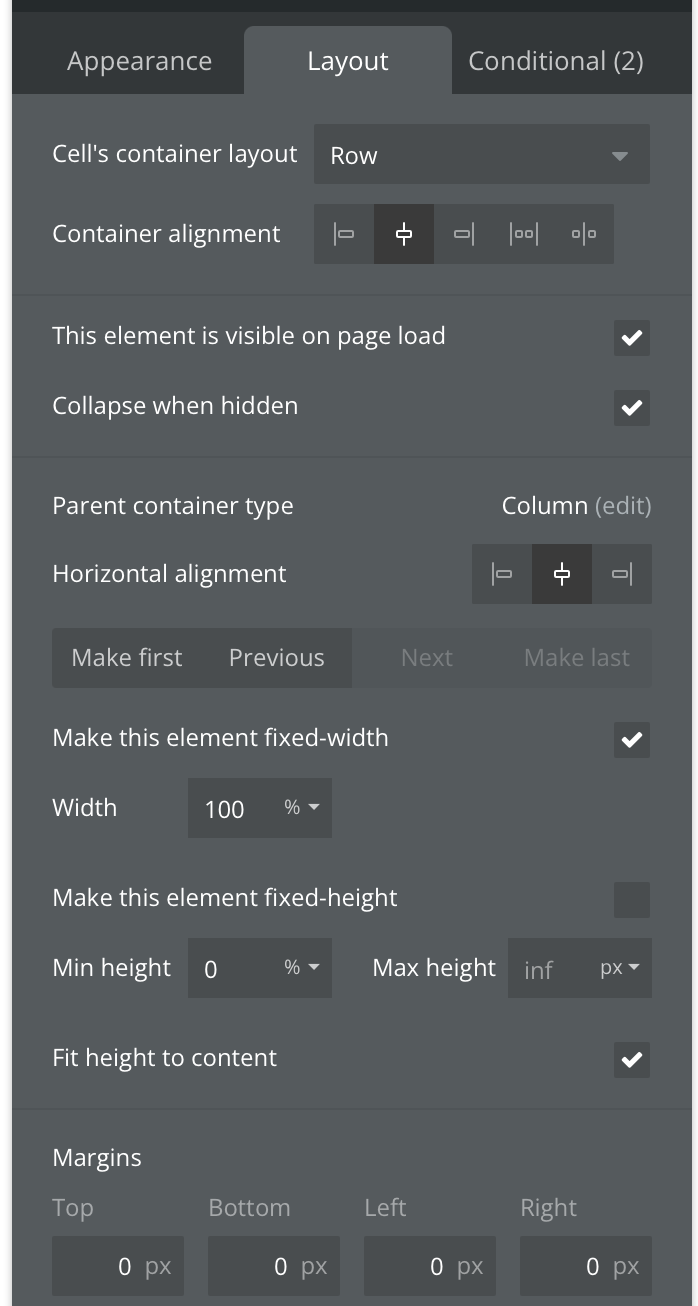

The rg:

Are the images I added the correct settings you recommended? Just wanted to follow up because I’m launching this app soon and have been struggling with this for a while. thanks for your help.

I made the parent group which contains the RG a column but I’m still having the same issues. do you know what else might be the issue? Here’s a view link to the app:
Try making the page a column instead of ‘Align to Parent’ on the Container layout dropdown
You’re talking about the index right? I made it a column and its still having that scroll issue. When I make the “News feed page” a fixed height of 555 for example, it fixes the problem. But when I do that, it’s not responsive to fit all mobile devices.
Do you know of a different way to make the height of that group responsive? I tried to set conditions to change the height when the of the page changes but it only has “when current pages width” as an option.
If you still have your RG’s parent group’s height set to 84% it’s gonna look like there’s something taking up space when it really is just a blank area.
So your RG’s parents is only taking up 84% of it’s own parent’s height and thus leaves that 16% blank.
