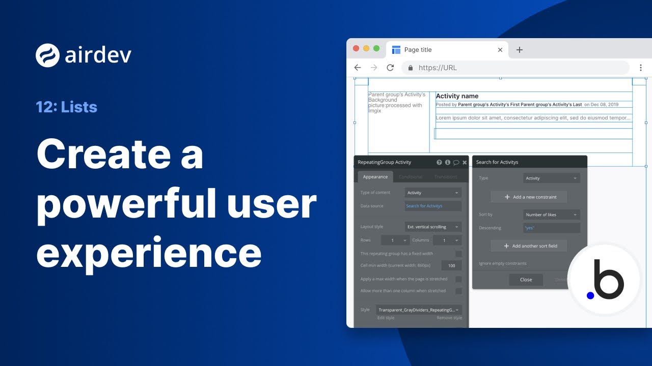

To re-visit how lists are managed in Bubble perhaps these resources can help:
