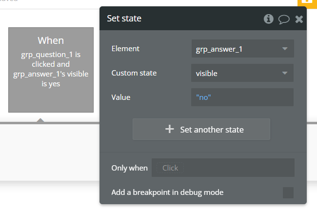

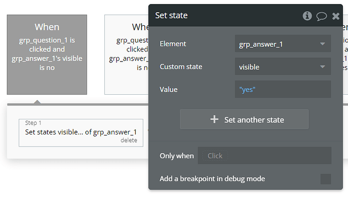

- Create two workflows for when “group_question” is clicked. One happens ‘only when’ group_answer visible is no and its action is set a state of an element (element: group_answer; state: visible; value: yes). The second happens 'only when group_answer visible is yes, the action is the same as the first one but the value is no.
Now it’s all set! If you use ‘copy special - copy with workflows’ and paste with workflows, you can change only the texts (and nomenclature, very important).
The downside: to hide group_answer the user would have to click on group_question again. Clicking outside it wouldn’t close it.
Here are some images and a 20sec video of a quick simulation I did:
