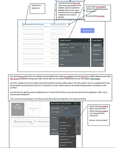

Hello all, I have seen this question and kind of answered a lot but it never seems like there is a definitive best practice on how to do this, yet its a very common function within any application.
How to update several rows of data in a list? Simple concept but not in Bubble so it seems.
I’ve attached my scenario below but long question short is How do I update all rows in a repeating group when an update button is pressed (not using auto bind).

Any answer happened for this question?
Here I am three years after you with the same problem. It is gross negligence this is how life is on bubble.
If it’s not AI it’s not on the roadmap. On the other hand I’m pretty impressed at the diagram that I made!
easiest way is using Orchestra plugin. like this.
