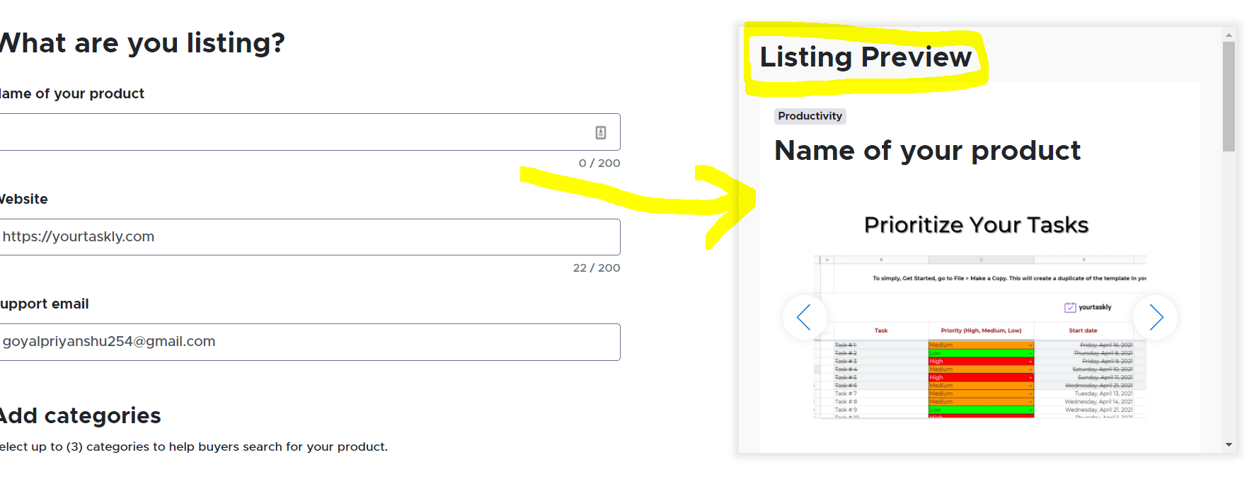

I want to have this type of live preview feature just like the one in below image where user is filling the form and automatically he/she can see the change in live preview.
How i can achieve this in bubble?

I would put it as a reusable element and setup things so the data is pulled from the DB…lots of other possible approaches as well. Maybe you could just use custom states.
I understood your first approach but how will you do this with the help of custom states.
I would use the inputs to set the custom state value and I would use the custom state as the data source for the ‘preview’
